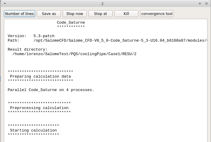

yesterday I accidentally closed the "simulation control window"
and then I run the shell command "code_saturne trackcvg" and I was able to retrieve my running simulation.

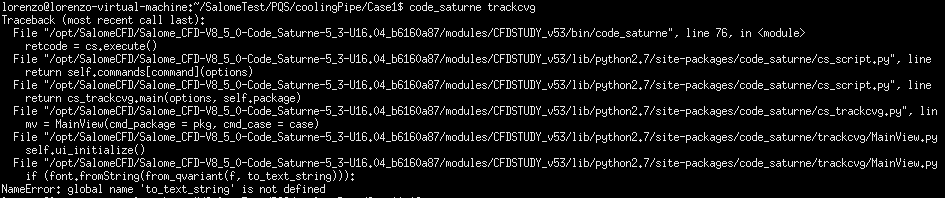

Unfortunately, from today I'm no more able to access the trackcvg funtion, both from GUI and from shell.
When I run from shell i receive the following message (Name Error: global name 'to_text_string' is not defined)
1) How can I fix this? I really need to restore the convergence monitoring tool.
2) Also, is there a command to re-open the "simulation control window" once it has been closed?

I do not think you can re-open the simulation control window once it has been closed, though you cann still control the simulation from the shell using the "control_file" mechanism.
The trackcvg tool also places a hidden "..trackcvg.state" file in the execution directory. If that file is in an incorrect state, simply removing it should fix the trackcvg error you have when running from the shell.
