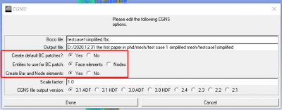

1. When export mesh from ICEM, I changed three options from default to: "Create default BC patches-Yes", "Entities to use for BC patch-Face elements", "Create Bar and Node elements-Yes", see the figure below. Is this correct?

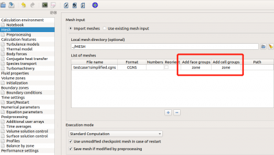

2. When import mesh to Code_Saturne 6.0.5 via GUI, I changed two options "Add face groups" and "Add cell groups" from default "off" to "zone", see the figure below. Is this correct? What does the options "off, section, zone" here mean?

Did you check the detailed documentation ? https://www.code-saturne.org/cms/sites/ ... tdesc_cgns
Your settings seem OK. Did you check/visualize the mesh import in code_saturne in "processeiing only" or "mesh quality only" mode (under mesh/execution mode) ?

Thanks for the link to CGNS documentation. I learned from that.
I selected "Mesh preprocessing only" under Mesh-Execution mode, ran preprocessing and got a preprocessor.log file (attached below). I found there are no errors in it. Perhaps my settings about meshes are OK.

Did you visualize the generated post-processing mesh ? And check the zones appearing in the run_solver.log ?
That should tell you whether everything worked as expected.

Thanks for your reply. I checked "surface with edges" of the results in paraview, which looks good. And the zones appeared in run_solver.log correctly. So I think the mesh importing worked well.
