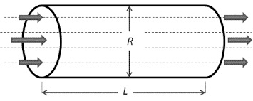

Now, I am trying pressure-driven flow for pipe as can be seen in As inlet and outlet conditions, I want to impose pressure value only.
For other parameters such as velocity and kinematic energy, I want to put them as a Zero value, becasue I want to check pure pressure-driven flow. (I will not use turbulence model, but laminar flow instead.)
For example, 100050Pa on inlet and 100010Pa on outlet are what I intend now.
