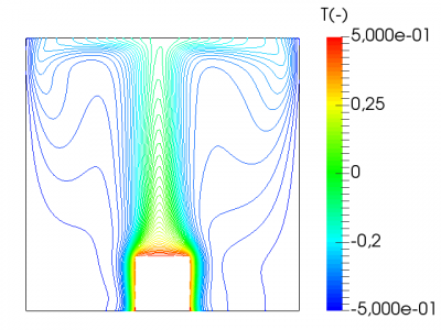

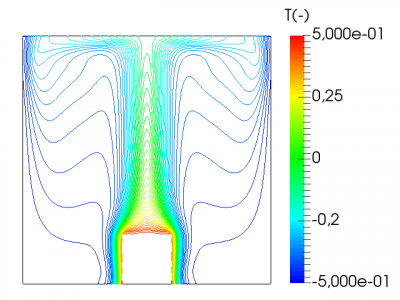

Here are the results without (symmetry) and with radiation.
Without radiation, the thermal field is symmety but consideration of gas radiation breaks it.
For accounting radiation, compared to the without case, i only modified the absorption coefficient in the GUI.
It seem this absorption coefficient is sensitive because when i enters another one (for a higher optical thickness), i got the symmetry solotions as expected.
The user subsoutines are only for the declaration of new variables and post processing.
