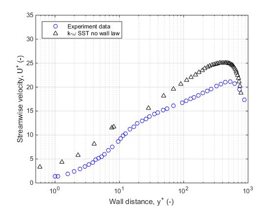

Re: Velocity at the wall
Hi Yvan,
The results that I am visualizing are in CGNS format. I open the same results file in both ParaView and FLUENT, the mesh is the same.
The dimensionless velocity, U+, was calculated using the wall shear stress extracted from Code_Saturne.
Do you know why the velocity is shifted upwards at every location, like in the above image?
I understood that near the wall, at the first point from the image above, Code_Saturne will compute a mean value, but after that the values shouldn't be closer to the experiment?
Thank you,
Ionut
I managed to run more simulations on different geometries like flat plate and flat channel, but I get the same issue with the velocity near the wall.Are you visualizing the same results files with ParaView and FLUENT (I assume in EnSight gold or CGNS format) ?
Or different computations on the same mesh ?
The dimensionless velocity, U+, computed with Code_Saturne follows the experimental data, but there is a shift in the values from Code_Saturne.Is the velocity you observe consistent with realistic values at the cell centers along the boundary ?
Thank you,
Ionut
