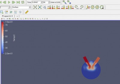

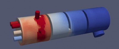

i have a problem in the the boundary conditions subroutine cs_user_boundary_conditions.f90, when i set the temperature change by time in the code as :
call getfbr('16',nlelt,lstelt)
if (ttcabs.lt.3.8d0) then
do ilelt = 16, nlelt
ifac = lstelt(ilelt)
rcodcl(ifac,isca(iscalt),16) = 20.d0 + 100.d0*ttcabs
enddo
else
do ilelt = 16 , nlelt
rcodcl(ifac,isca(iscalt),16) = 400.d0
enddo
endif
call getfbr('18',nlelt,lstelt)
do ilelt = 18, nlelt
rcodcl(ifac,isca(iscalt),18) = 20.d0 + 100.d0*ttcabs
enddo
else
do ilelt = 18 , nlelt
rcodcl(ifac,isca(iscalt),18) = 400.d0
enddo
endif
in two inlets, which are above the cylinder , i notice in paraview that they have same variation (in red )as the other two inlets which are in the side of cylinder) , as shown in the picture attached
does that means the temperature variation by time are not working properly ?
Thank you

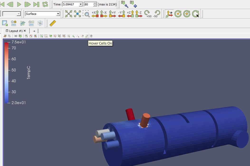

the problem is that the temperature result , is not showing the maximum temperature as prescribed in the subrouting where i impose in these two inlets , when t >= 3.8 sec , Temp = 400, as shown in the picture , time is more than 3.8 sec (5sec)
PS : i put in the other 4 inlets in the side of cylinder , a constant temperature of 15°
where we have the max Temp is only 75°, PS : i put in the other 4 inlets in the side of cylinder , a constant temperature of 15°
