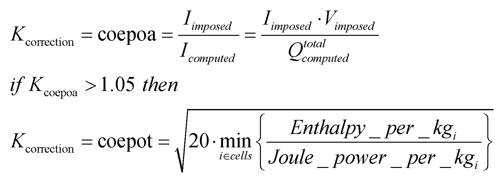

When I switched my electric arc model from the LTE simulation with just one thermal scalar to two thermal scalars I found that the arc fades away every time. The total Joule power goes down as well as the voltage. I started looking for a reason and found that in the arc voltage scaling algorithm we have the following formulas for the correction coefficient:
Kcorrection = coepoa = Iimposed/Icomputed = Iimposed*Vimposed/Qtotal_computed
but if coepoa >1.05 then
Kcorrection = coepot = SQRT(20*MIN{(Enthalpy per kg in cell i)/(Joule power per kg in cell i)})
So I corrected it in order to take into account both enthalpies, but the arc still fades away.
Could you please tell me what am I doing wrong with this scaling algorithm and what is the origin of the second formula for the correction coefficient? Probably it must be changed to implement the 2T model? I am a little concerned especially by the number 20 in the formula.

Hello Rodion,
I am not sure i am of much help here, as you are probably more knowledgeable in the electric arcs model than I am. So I can only suggest general troubleshooting recommendations.
I may see a colleague who worked on this module tomorrow, so I can ask for recommendations, but I would be tempted to disable the correction factor altogether (forcing it to 1), or limit it to values near 1 (as I assume it is here to compensate for numerical/rounding issues which should remain small). A first test would be to check (for example print) its value.
I'll keep you informed if I have any news on the "20" factor.
