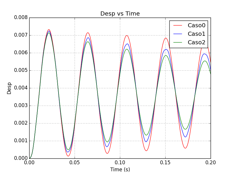

Yes, we are trying to solve the same problem. I solved a structural problem with CA with the help of a colleague, using the dyna_non_line in order to characterize the added damping to the structure using the AMOR_ALPHA and AMOR_BETA in the material definition. I attach a fig with the results of the displacements of the beam with a constant pressure applied to one face for different damping values.
This behavior (unstable or conditional stable) is typical in partitioned coupling scheme when using similar densities (fluid/solid). The use of structural predictors and internal iterations in order to get a strong coupling could help.
