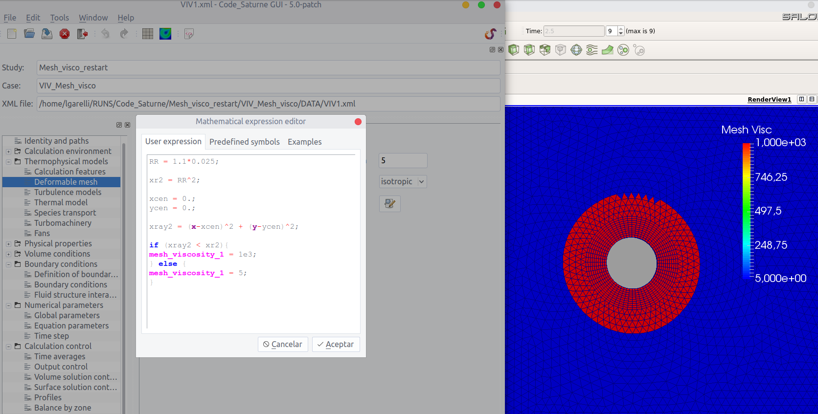

Here is an example of use (linux version),
jankolino wrote: Mon Jun 25, 2018 8:47 pm For me, the GUI never accepts my code.
Your "scalar" is computed inside the MEI or it is a variable of your problem. Did you check that it exist in the predefined symbol list.
Luciano
