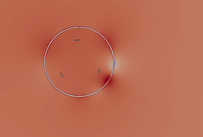

Thank you. I will try to improve the time step. There is no diverge shown on the listing file, but the maxmum velocity is so large. I check the result in Paraview when I choose transition_coupled. and found the problem on the interface of rotor and stator. The figure shows the pressure of flow field. I also attached other info I can provide. Could you please find any problem about that?
When I chose full transition module , the error output is "SIGSEGV signal (forbidden memory area access) intercepted!" before the calculation. I found this because I choose the periodic boundary condition. When I use symmetry boundary condition, the case can run. So I think the periodic boundary condition can not go with the transition module???
