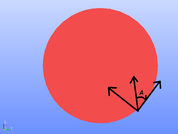

I managed to fix the angle for the previous case but now I have another question. Let's say that we have a simple cylinder ( Figure 1) and this time the inlet is the one shown with red. Is there any way to set a volumic flow rate as boundary condition and to input an angle A as shown in Figure 2 using the user profile? So far I managed to control the angle but in the axial direction( z axis) and I want to control it in (x,y) plan in order to get a swirl.
Thank you,
Robert
Figure 1
Figure 1
Figure 2
(7.72 KiB) Not downloaded yet
Posts: 4290
Re: Tangential velocity
No, there is currently no alternative to this than using user subroutines (cs_user_boundary_conditions.f90). I'll need to check if we already have examples for swirls in the Doxygen documentation, and possibly add one, as inlets with swirls are a (moderately frequently) recurring question...
