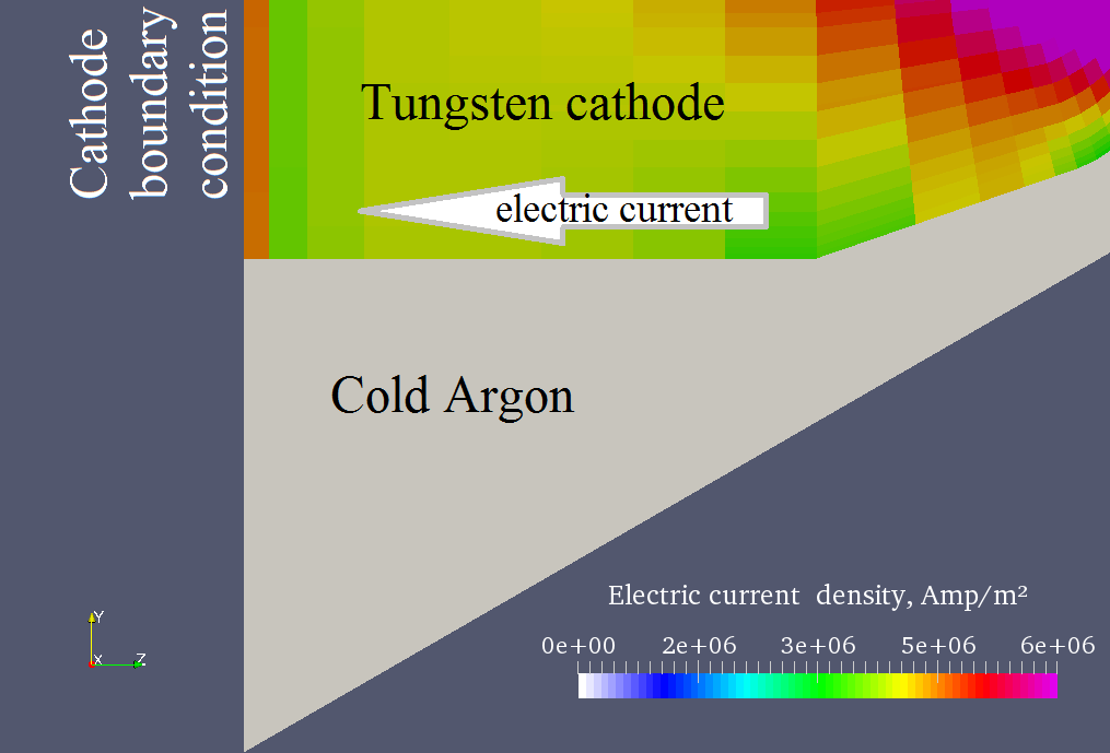

Also there is a strange phenomenon with the electric current density distribution: in a cylindrical electrically conducting cathode the boundary cells have higher electric current than the internal cells. Which gives us higher total electric current in the boundary cells. And hence, we get nonconservation of electric current. Please find the picture attached. Is it supposed to be like that or it is a mistake?

Also there is a similar problem in electric current density distribution.
Do you know what can be the reason? Probably the gradient calculation for boundary cells has some problem?

At the same time electric current density is a property derived from electric potential. Electric current density field has this problem with high values in boundary cells for different CS versions, for different geometries and for different types of boundary conditions for electric potential (either Neumann or Dirichlet).
