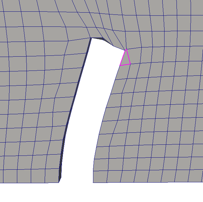

As shown in the attached file, I have a solid deformed by the fluid. As you can see the purple cell is distorted, and as the time evolves, finally we can have a negative volume of this cell.
So I imagine that the ALE module in Saturne does not check the validity of the mesh. Maybe what I need to do for my application is just to modify the subroutine for the calculation of mesh velocity, for example in the purple cell, if the velocity of the nodes in the right side of the interface is calculated large enough, there would not be a negative volume. This should be much more easier than implementing a remeshing module in the code. What do you think about it? As I have no idea how the ALE module is in Saturne, so could you please give me some indications?

Yes, this particular case should not need remeshing, if you can distribute the deformation over a sufficiently large region around the deformed zone, rather than over just the neighboring cells.
This is automatic using the future "CDO" based mesh deformation (already showcased by the boundary layer insertion options in development trunk), but with the current ALE module, I am not sure. I think the two main factors which may impact this are the time step and the mesh viscosity so you should experiment with those.

I have tried to define a very large mesh viscosity (1e10) in the vicinity of the moving solid, and a small one (1) for regions far away from the solid. And I also have tried small time steps. For the moment, I still have no correct results.
After reading some references on mesh velocity calculation, I think that maybe I can implement a method which calculate directly node-based mesh displacement/velocity instead of cell-based mesh velocity as has been done in code_saturne. In this way, I can control directly the nodes in order to avoid mesh distortion.
