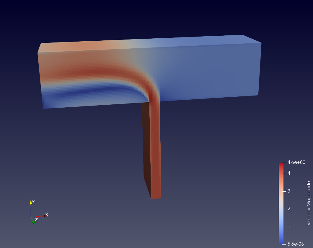

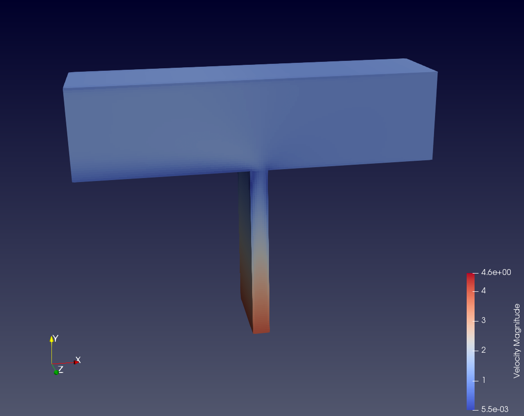

I am a beginner of Code_Saturne. Recently, I carried out a coupled simulation of two code_saturne instances, which is a 3D T-junction with a velocity inlet at the bottom (4m/s), a outlet on the left hand side of the top structure and another inlet on the right hand side of the top structure (1m/s). The top and bottom structures were simulated with separate unsteady solvers and coupled with each other at the middle interface. The following figures show simulation results of the coupled simulation, in which it is clearly that the continuity equation is not converged - see the sudden jump of pressure field near the interface. I tried various time step sizes and total numbers of iterations, the simulation results all reach a similar steady state as shown in the following figures. I checked the residual of the field variables and found that, for the top structure, all equations are converged, however, for the bottom structure, the normalized residual of the pressure equation remains a value around 0.99 and doesn't change with time advancing. can anybody give me some advice about this? Many thanks
Velocity field of a non-coupled simulation

Velocity field of a coupled simulation
