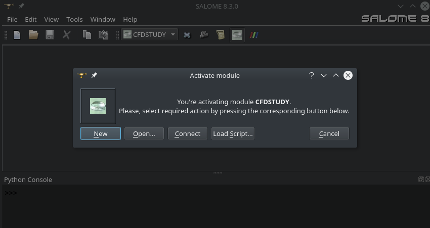

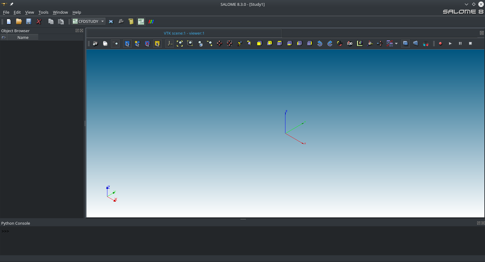

I followed your instructions and configured and maked code_saturne from scratch. I attach two screenshots I taked just after starting "code_saturne salome". The result looks promising, although according the tutorial
https://www.code-saturne.org/cms/sites/ ... tyFlow.pdf (pages 8 and 9) there are several options/things missing.
Bellow you can find the error messages shown in the command line.

Posts: 4303
Re: Error while compiling CS-5.0.4 + Salome-8.3.0 under open
This seems to be a bug introduced by the Salome_CFD packaging (not yet publicly available, but hopefully, shou should be able to download a precompiled Salome + CFD_Study/Code_Saturne in the future).
I'll fix it in version 5.0.5, but in the meantime, if you simply run:
export CS_ROOT_DIR=/home/pablo/Programas/code_saturne/5.0.4
before running "code_saturne salome"
you should be OK.
Best regards, and sorry for the bug.
