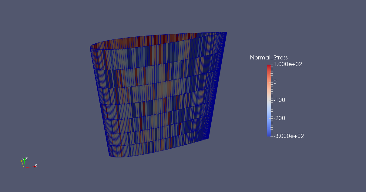

I'm using the full transition simulation module and I have got the outputs of force. I attached the result of normal stress on the wall surface. But it looks so strange. could you please give me some advice about that? Thank you so much.
