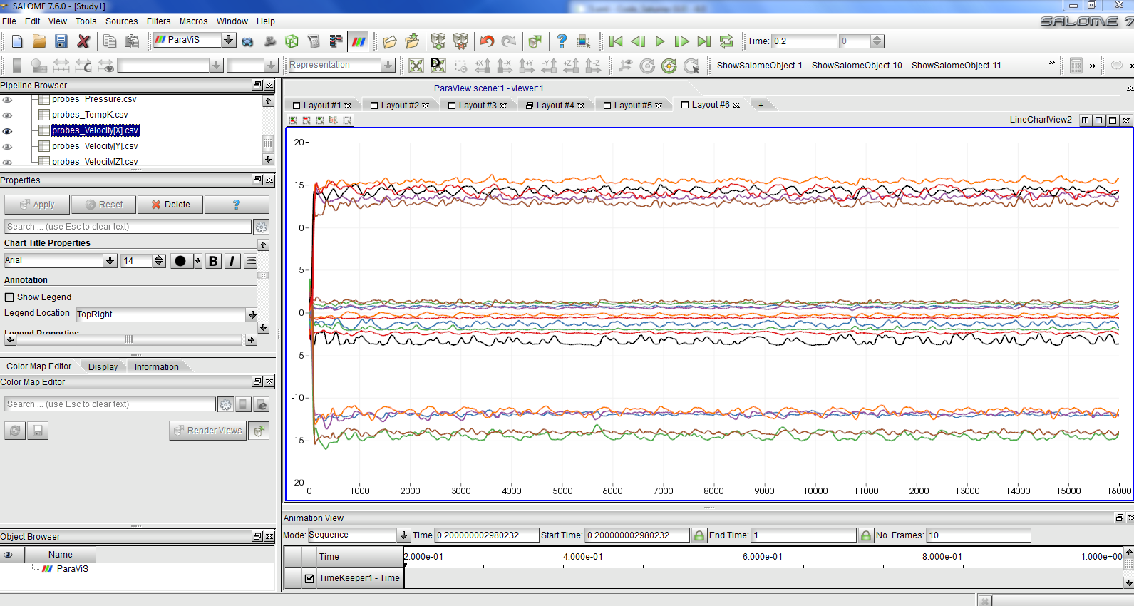

Based on the previous calculations, I found the thickness of the boundary layer which is above the cardboard, and then I re-adjusted the monitoring points, all of them are at the nozzle and above the boundary layer a little bit. I recalculated once with the 0.0001 reference time step, iterating over 16,000 times. But the convergence result is the same as before, the residuals are very small, but the derive is very large, my listing is in attachment.
But the good news is that the pressure, the temperature and the velocity of those monitoring points are stable, only a small fluctuation.
The stability of pressure and temperature are very good: Best Regards

Re: How to plot residuals in Windows?
The velocity of X, Z direction are very stable, but the stability of Y direction is not very good nor bad:
Omega's stability is also very good:
But the stability of K is poor:
So I can think it is convergence?

Can it be considered as convergence, according to my monitoring points?

To monitor for convergence, I recommend more probes. You frobably have a fluctuating flow, which never quite stabilizes but stays in the same area. In this case it may be useful to define time averages for postprocessing, and use those.
