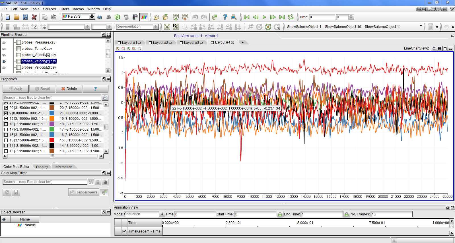

I have set up 14 monitoring points where I am interested. Here are the Pressure, Temperature, and Velocity(X,Y,Z), I have set up the density of air is constant. Pressure and Temperature are very steady.
But Velocity is very unstable. I have calculated 25,000 iterations. Can i say it converges?

Re: How to plot residuals in Windows?
Here are Velocity Y and Velocity Z:

The code does seem to fluctuate (with large fluctuations) around a median value.
You may output time averages (see postprocessing options) to obtain average value, but there may be an issue with your mesh quality or time step. What does your "listing" look like ?

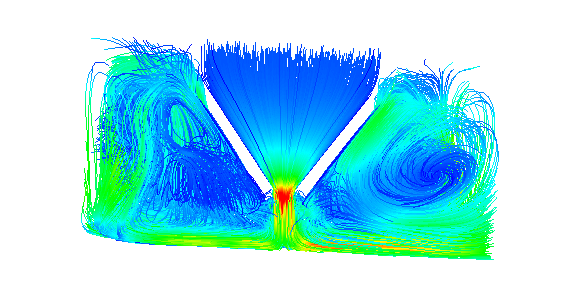

So I realized that there might always be unstable vortices on both sides of the nozzle, like this:
And it would never converge, and I would focus on the velocity of the nozzle and the distribution of heat and velocity above the cardboard. Once they are stable, I think the whole system is stable. After all the other places I do not care.
So I have set up the monitoring points where I am interested, Just as I uploaded the picture before, the temperature and pressure are very stable, but the velocity is still unstable, no matter how much I calculate. Fortunately, the flow of inlet and outlet have always been balanced.
