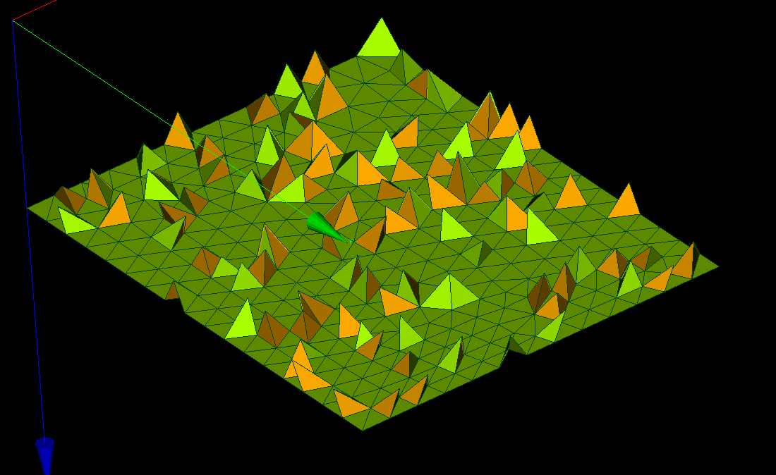

Now the simulation is running and i can see that some faces are not marked as "heat" boundary in the resulting mesh, maybe this happens because the face property is stored in the ghost domain and then it is lost ?

Thanks to your kind help now the simulation is working very good. I'm able to see the mesh evolving following the rules i have defined. however i don't know why some errors appears at a certain point.
