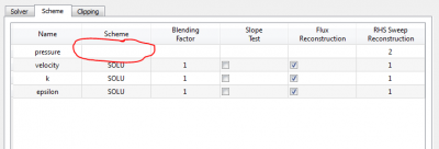

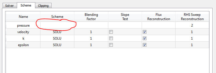

Hi
What kind of scheme it is used for Pressure in the 'Scheme' tab from the 'Equation Parameters' menu?
I attached a picture too. showing the issue that I have.
Thank you,
Ionut
Thank you,
Ionut
- Posts: 4077
Re: Code_Saturne_Automatic scheme and Low_Re_models Convergece
This is not an "issue". The pressure is not a convected variable, but handled in the velocity-pressure algorithm. You can check the theory guide if you need more details.
