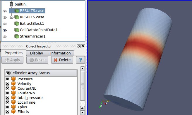

Re: wall continuity
Thanks Yvan,
I have tried 'cutting' a sphere in a cylinder in Salome, with no continuity between sphere and cylinder. It works well.
Perhaps my previous error was to use a solid sphere...
Now I would like to apply the StreamTracer filter in Paraview, but nothing comes out ...
Regards
Gregory
Regards
Gregory
- postprocessing.zip
- (525.83 KiB) Downloaded 526 times
- view1.pvsm.zip
- (10.45 KiB) Downloaded 505 times

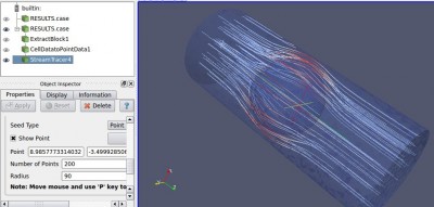

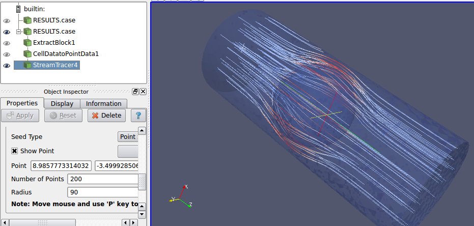

Re: wall continuity
Thanks.
In 'StreamTracer' I have increased the number of points and placed the central point. I have also increased the 'maximum streamline length' to 2000.
The result is more interesting !
(with default length the lines seemed to break just around the sphere in the maximum velocity zone )
Regards
Gregory
