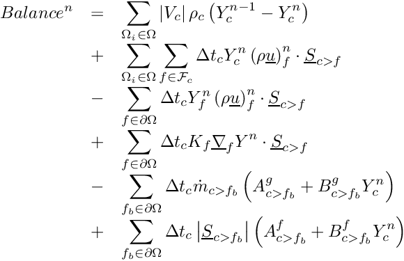

The balance at time step n over a subdomain $ \Omega $ of boundary $ \partial \Omega $ is equal to:
\[ \begin{array}{r c l} Balance^n &=& \displaystyle \sum_{\Omega_i \in \Omega} \norm{\vol{\celli}} \rho_\celli \left(\varia_\celli^{n-1} -\varia_\celli^n \right) \\ &+& \displaystyle \sum_{\Omega_i \in \Omega} \sum_{\face \in \Face{\celli}} \Delta t_\celli \varia_\celli^n \left(\rho \vect{u}\right)_\face^n \cdot \vect{S}_{\iface} \\ &-& \displaystyle \sum_{\face \in \partial \Omega} \Delta t_\celli \varia_\face^n \left(\rho \vect{u}\right)_\face^n \cdot \vect{S}_{\iface} \\ &+& \displaystyle \sum_{\face \in \partial \Omega} \Delta t_\celli K_\face \grad_\face \varia^n \cdot \vect{S}_{\iface} \\ &-& \displaystyle \sum_{\fib \in \partial \Omega} \Delta t_\celli \dot{m}_\ib \left(A_\ib^g + B_\ib^g \varia_\celli^n \right) \\ &+& \displaystyle \sum_{\fib \in \partial \Omega} \Delta t_\celli \norm{\vect{S}_\ib} \left(A_\ib^f + B_\ib^f \varia_\celli^n \right) \end{array} \]
The first term is negative if the amount of scalar in the volume has increased (it is 0 in a steady regime).
The terms of convection and diffusion (at internal or boundary faces) are positive if the amount of scalar in the volume has increased.
In a steady regime, a positive balance thus indicates a scalar gain.
