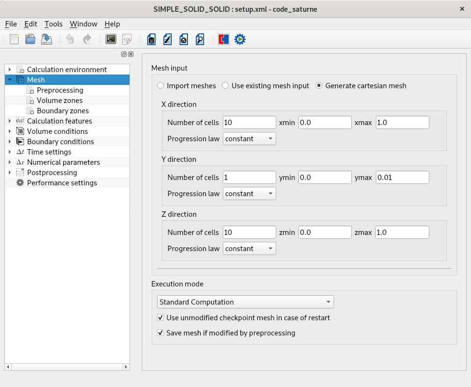

One assumes that the mesh is a Cartesian mesh generated using the GUI but other ways are also possible. A more detail description of the different preprocessing possibilities is available here
GUI: Cartesian mesh definition

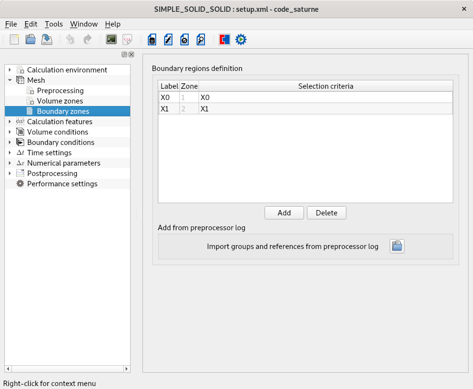

The generated Cartesian is built with 6 mesh face groups collecting boundary faces and named X0, X1, Y0, Y1, Z0 and Z1. These mesh face groups are used to define the two boundary zones needed for this example. One proceeds as detailed in the GUI screenshot.
