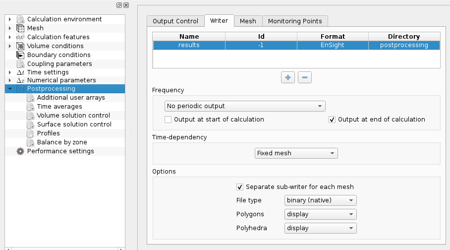

  • A writer combines the definition of an output type, frequency, path, and name. One or more writers can be defined using the GUI and the cs_user_postprocess_writers user function.

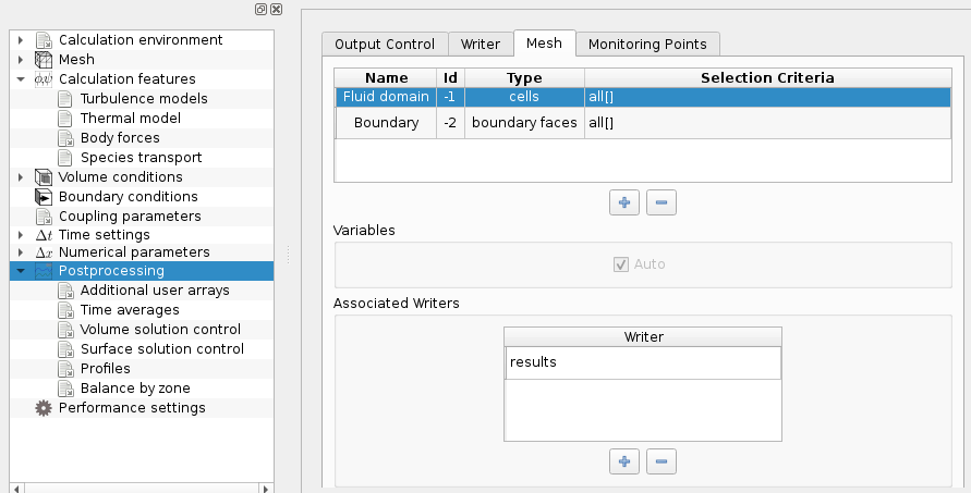

  • A mesh is based on a subset of the the computational mesh, or point sets such as particles or probe sets. One or more meshes can be defined using the GUI and the cs_user_postprocess_meshes user function.
The combination of writers and meshes allows generating chronological outputs in EnSight, MED, or CGNS format, as well as in-situ visualization using ParaView Catalyst or ensemble data output to Melissa.
Using the GUI, writers can be managed and defined in the following page:
And postprocessing meshes can be handled in the following tab:

The default meshes are initially associated with the default writer. If new meshes are defined, they are not associated to any writer by default, so the writers which will be used for the matching output must be associated.
To prevent output related to a given mesh (including the default), the list of associated writers should be made empty.
Note that the default writer and meshes cannot be "undefined", though they may be renamed and their settings modified. A writer with no associated mesh is inactive, so removing the default writer from the list of writers associated to all meshes deactivates the default output.

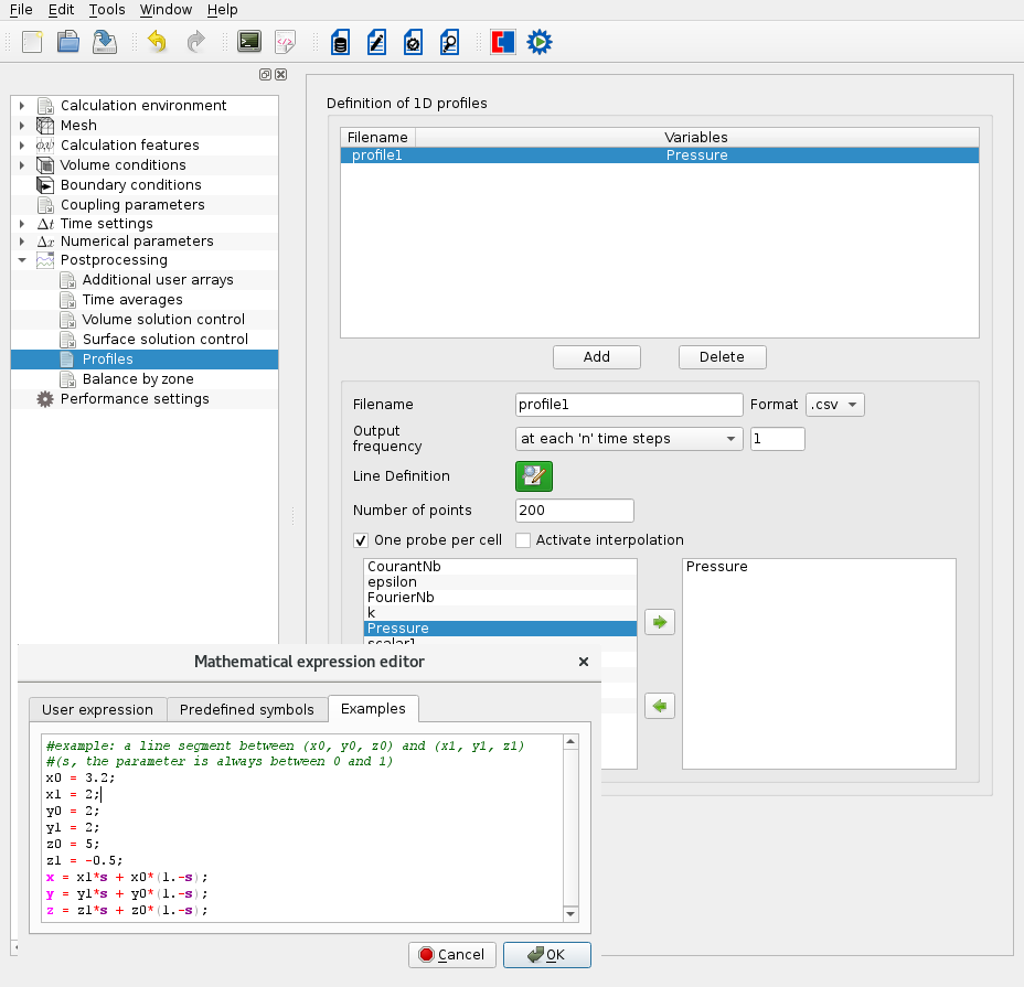

Profiles are defined as a special type of probe set, for which a curvilinear coordinate (the local profile coordinate) is defined, and are typically used not with time plots, but with simple plots (also in CSV or text format) where one file is associated to a single time step, and columns correspond to different variables, and lines to different positions along the profile.
Probe sets and profiles are defined as a special category of postp-rocessing meshes, so they can be also be used in combination with most other types of writers.
The GUI currently only allows handling a single (default) probe set for time plots. Probe coordinates can be entered directly or read from a CSV file.
Profiles are also handled in a specific manner, as they are automatically associated with default simple plot writers (CSV or text), and the associated variables may be selected specifically.

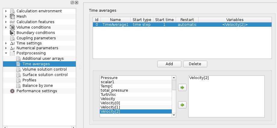

Time averages
In code_saturne, it is possible to define time moments for existing variables (fields) or user-defined formulas, including both means and variances. This is limited to visualization output, so for example although the variance of a vector (which is a tensor due to the covariance terms) may be computed, the variance of a tensor may not (though that of specific components may always be computed).
This computation uses recurrence formulas, so at any given time steps, the mean or variance field values are always updated and accessible as a regular field. The computation of time moments may start at a user-defined time step of physical time so as not to include transient initialization data. In this case, the associated field values before actually starting the moment updates is 0.
Time moments may be defined in the GUI, as shown below, or using the cs_user_time_moments function in cs_user_parameters.c (see Time moment related options examples).

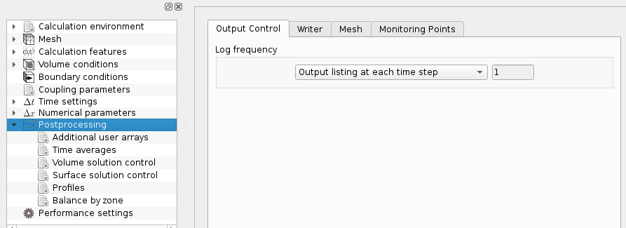

Logging
The logging output frequency may be managed using the GUI, as shown below. The first 10 time steps are always logged. When running many time steps, it recommended to use a logging period greater than 1 (20 or 100 are often sufficient), as logging each time step with even a moderate verbosity can lead to large run_solver.log files.
Note that logging verbosity is also influenced by the verbosity used for solved variables.
