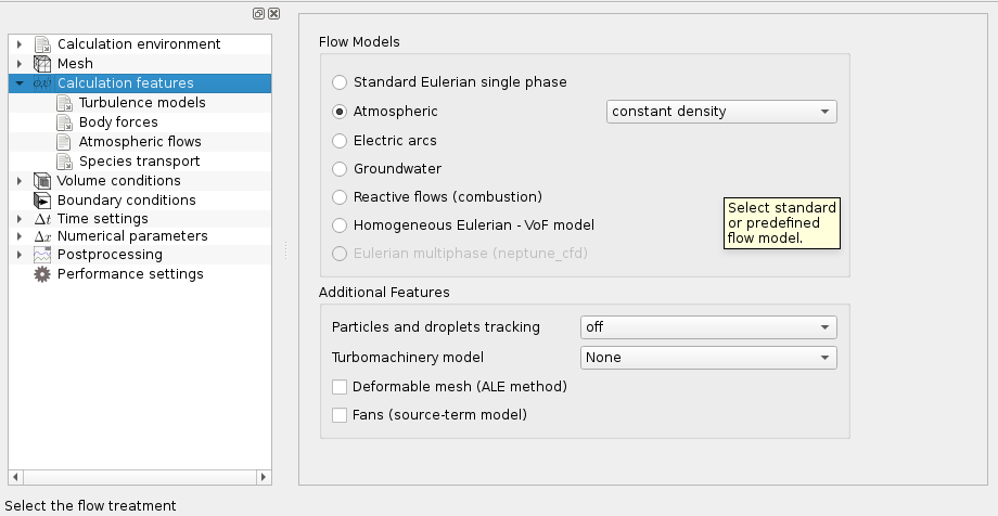

The GUI may be used to enable the atmospheric flow module and set up the following calculation parameters in the Thermophysical models - Calculation features page see fig:steady.
The user can choose one of the following atmospheric flow models:
), otherwise pressure and density won't be correctly computed.
), even if the density is constant.The specific heat value has to be set to the atmospheric value

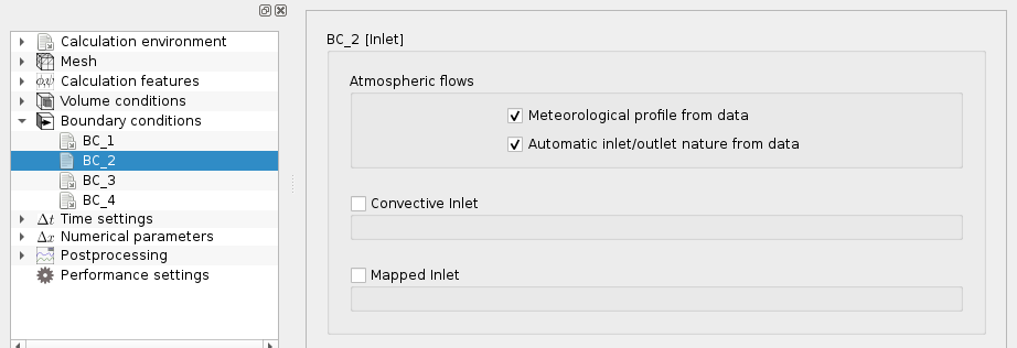

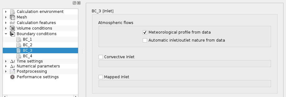

The meteo file can be used to define initial conditions for the different fields and to set up the inlet boundary conditions. For the velocity field, code_saturne can automatically detect if the boundary is an inlet boundary or an outflow boundary, according to the wind speed components given in the meteo file with respect to the boundary face orientation. This is often used for the lateral boundaries of the atmospheric domain, especially if the profile is evolving in time. In the case of inlet flow, the data given in the meteo file will be used as the input data (Dirichlet boundary condition) for velocity, temperature, humidity and turbulent variables. In the case of outflow, a Neumann boundary condition is automatically imposed (except for the pressure). The unit of temperature in the meteo file is the degree Celsius whereas the unit in the GUI is the kelvin.

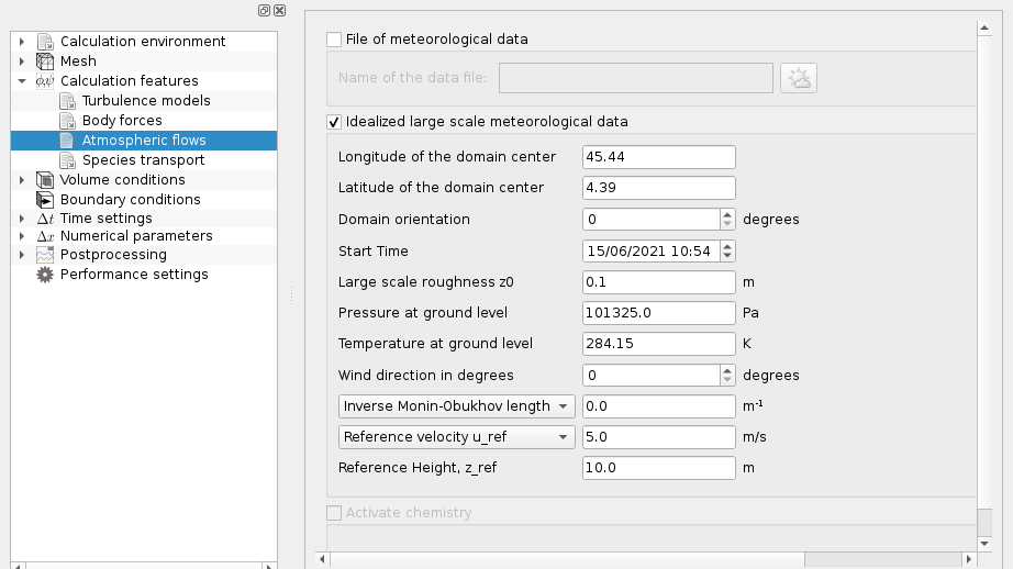

To be taken into account, the meteo file has to be selected in the GUI (Atmospheric flows page, see fig:meteo) and the check box on the side ticked. This file gives the profiles of prognostic atmospheric variables containing one or a list of time stamps. The file has to be put in the DATA directory.
An example of file meteo is given in the directory data/user/meteo. The file format has to be strictly respected. The horizontal coordinates are not used at the present time (except when boundary conditions are based on several meteorological vertical profiles) and the vertical profiles are defined with the altitude above sea level. The highest altitude of the profile should be above the top of the simulation domain and the lowest altitude of the profile should be below or equal to the lowest level of the simulation domain. The line at the end of the meteo file should not be empty.
If the boundary conditions are variable in time, the vertical profiles for the different time stamps have to be written sequentially in the meteo file.
You can also set the profiles of atmospheric variables directly in the GUI. The following boundary conditions can be selected in the GUI:
