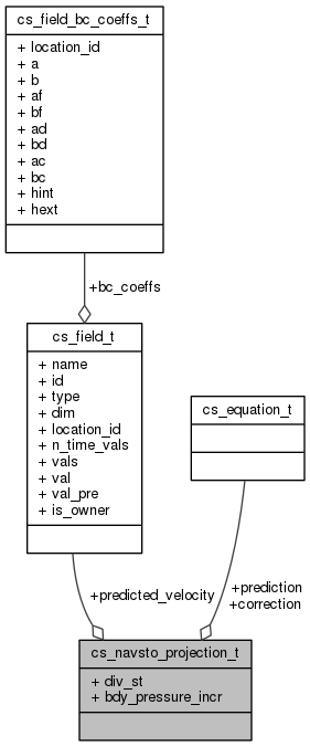

Collaboration diagram for cs_navsto_projection_t:
Collaboration graph
