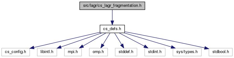

cs_lagr_fragmentation.h File Reference
Include dependency graph for cs_lagr_fragmentation.h:
