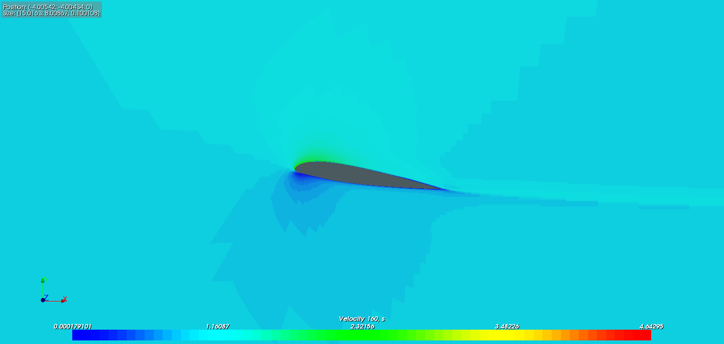

Hi César,
Very nice script.
I followed the steps you indicate in your post, i.e. generate a gmsh script with your script, importe it in gmsh and saved it as MED file. Now, when I import this MED mesh in saturn, I receive a connectivity error for some elements (see MED file attached). Do you know how to correct this error?
Thanks for your help

Some tools (possibly Gmsh) are bad at orienting cells according to the MED numbering, or orienting all cells consistently when using operations such as symmetry.
I am not sure this is the case here, but did you try the "reorient" feature of the Code_Saturne Preprocessor (either through an option in the mesh selection with the GUI, or as a --reorient command-line option to cs_preprocess)) ?

Hi
Thanks for the hint. The complete sequence look like this for me:
1) generate the GMSH file using Cesar's script, for example:
$ foilgmsh ('n23012.dat',7.5,50,'a',3000000,0.3,198.16,[100,40,25,15],0.01)
2) generate the MED mesh via gmsh (see above description), and save it as MED (file name in this example n23012.med)
3) run code saturne mesh check with following options:
$ cs_preprocess --reorient --med --volume -m n23012.med
4) load the file named "preprocess.med" in code_saturne and run your analysis.
Here you are! You have it runing!
Thank you for your help
