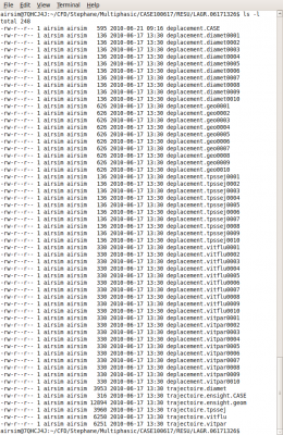

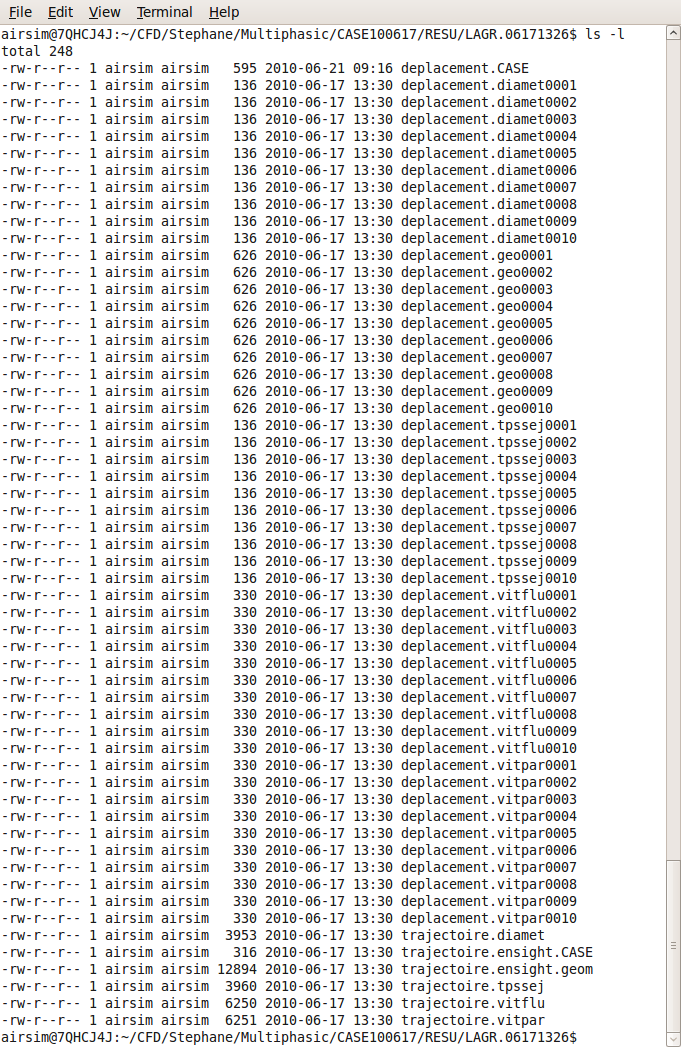

Stéphane Blanchet
Re: Problem with the post-treatment in diplacement mode
Oh sorry, I did not see the first message.
Here is the file list.
I use Paraview 3.6.2 for the post-processing.
Stéphane
Stéphane
David Monfort
No problem! It seems everything is present in the directory...
