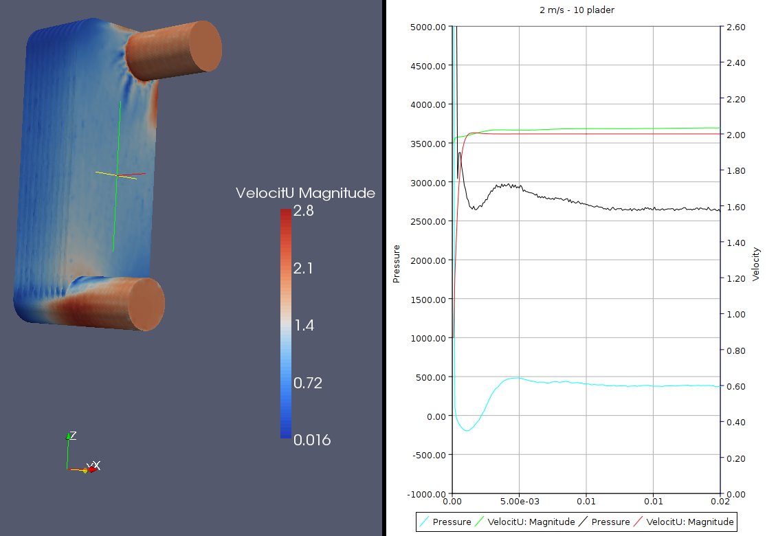

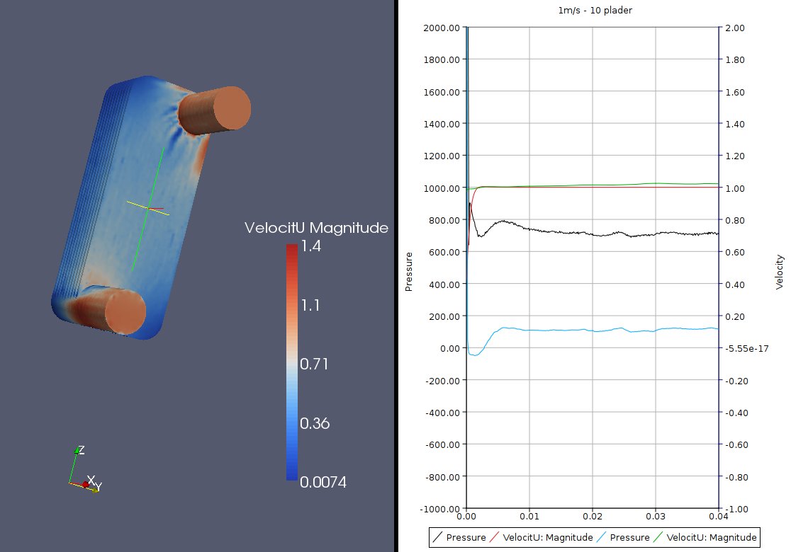

Claus Andersen
Re: Boundary cond. for inlet
Just wanted to follow up on my case; It worked fine when I severely lowered the timestep - luckily I didn't need to track a particle through the whole geometry, otherwise the simulation would have taken 50 hours per run :S
The pressure difference I got was way too low, but that was expected since I didn't model the corrugation of the individual plates of the plate heat exchanger - otherwise the results was within the range we finally got from the supplier. The results were used to ballpark a total pressure drop of the system in the initial design phase. So mission accomplished
Attached is a screen shot from Paraview.
Thanks for the help.
/C
/C
Claus Andersen
First post contains 1m/s inlet with 10 plates - this post 2m/s inlet with 10 plates
