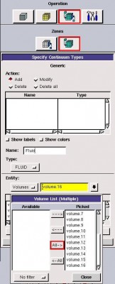

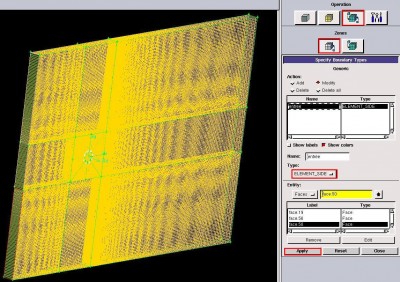

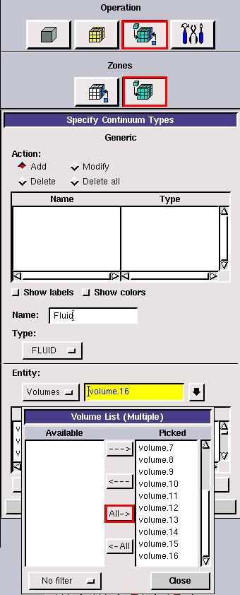

A possibility of your problem is the definition of solver in Gambit. In fact, you should define generic solver in Gambit to have a support of boundary conditions in neutral file. To verify this problem you can read the neutral file with notepad or an other software and verify the number of boundary conditions and their name. After the selection of generic solver, you can select your boundary conditions on faces with Elemnt_side as type and after you define your real type in Code_Saturne or you can select a volume to define Fluid and Solid conditions in the second button of Gambit. You can see the definition in my pictures.

Thanks for your quick answer. I lost the BC defined in faces in Gambit and I am using Code Saturne RC 2.1.
I will try to define the BC as element_side type and I will get back here to forum to post the result.

First of all thanks for your pictures. As I said to Yvan I will follow your approach of defining the BC as indicated in your first picture and I will get back to post the result.
In fact I opened the neutral file as Notepad and it only has 2 BC defined which I believe are the two continuum types (fluid and solid that I defined in Gambit).

Just to make the update. After defining the BC in Gambit as element_side everything was well imported in Saturne. It worked.
Thanks a lot and good weekend.
