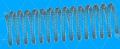

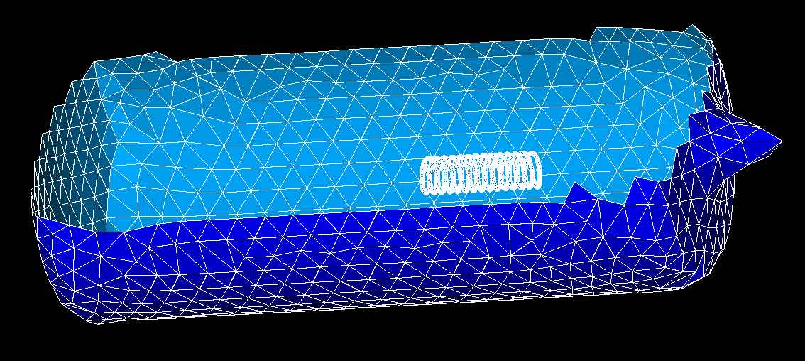

I am trying run a thermal simulation of an H7 halogen bulb with conduction, convection and radiation. I am using SYRTHES coupled with Code_Saturne. I already managed to run this simulation with a simplified geometry. I used a simple cylinder for the coil geometry.

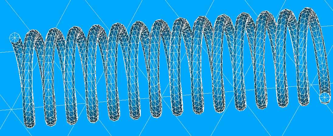

After that I changed the mesh and used the real geometry of the coil. But with the new mesh the generation of the form factors for radiation – which needs more than two hours on my computer – always fails with this error:
At first I thought something is wrong with the mesh and I remeshed everything carefully, but the error still occures.*** CFDF3D : calcul des facteurs de forme
