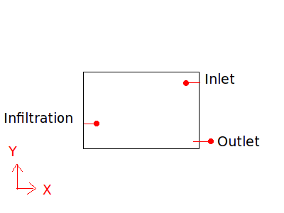

As for the mass flow, here is the xml file of the case I currently study, where a negative speed is imposed. The characteristics of the geometry are:
INLET: S=0.0015m², U=-2.77 m/s, Flow= A = -0.486E-2 kg/s
INFILTRATION: S=0.0028m², U=0.446 m/s, Flow= B = 0.146E-2 kg/s
(see the attached schema)

David Monfort
Re: Ending the calculation / Mass flow direction
Post by David Monfort »
Hello Axel,
The results seem fine to me. Mass fluxes are always taken negative for inlets (u.n < 0 where n is the boundary face normal, always oriented towards the exterior) and positive for outlets (u.n > 0).
Concerning the oulet condition, I would advise you to first test with the standard condition: the velocity will indeed "carry" the heat out of the room except if you have backward flow (the behavior is then a bit more complex... see e.g. the comments at the beginning of the usclim.F subroutine.).
