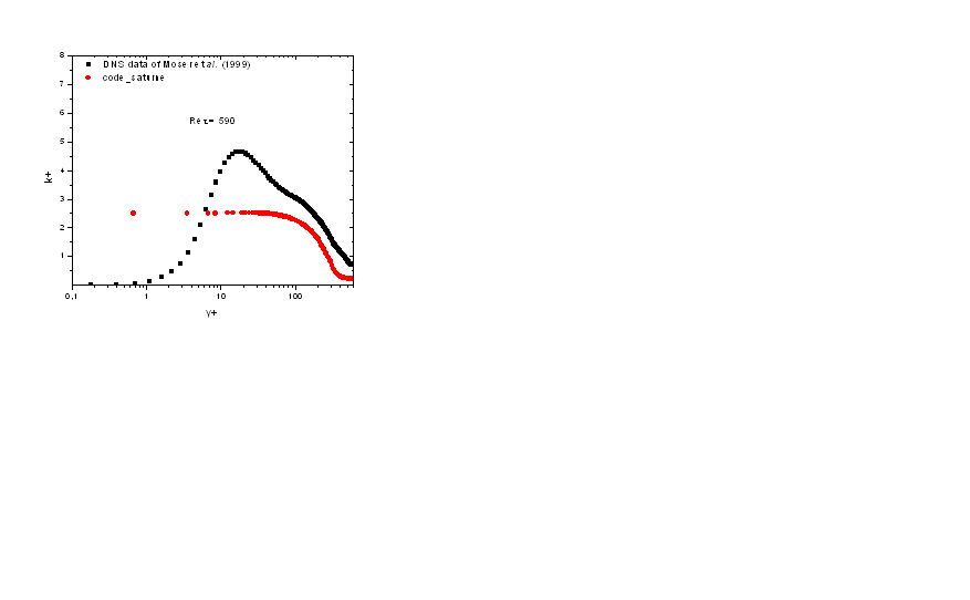

Re: 2D turbulent channel flow: pb with TKE results
Dear all,
Could somebody orient me! Perhaps I do a mistake that I cant see well...
you can found as attached my saturn result compared with DNS
Please i need your help
Gina,
i think you attempt to reach a turbulent Reynolds of 590, is that correct? With you set up , this is not the case. More over you don't use the correct values for fluid properties (specially viscosity). I follow the papers you send me and i have same order of value on the turbulent energy (i didn't change the viscosity here). I send you my xml file in attachment.
Mickaël
Mickaël
