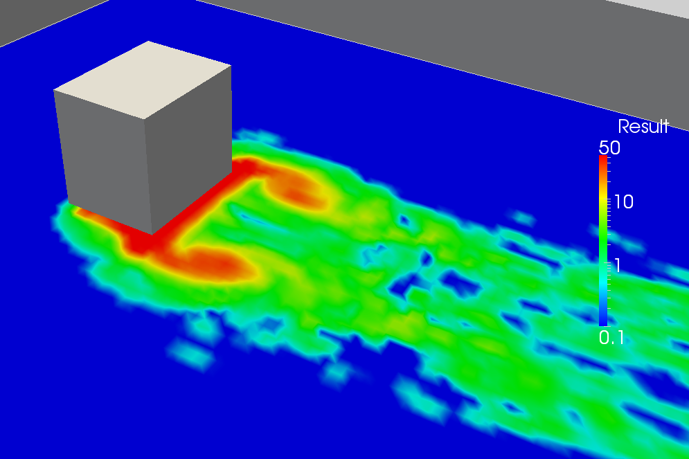

i am running Code_saturne CS2_RC2 on a atmospheric case with a frozen wind field and dispersion with the lagrangian model.
Both lagrangian and atmopheric modules seems not fully compatibles : the particles always go up. There is may be a problem with the hydrostatic pressure.
Anyway my validation case is a windtunnel case, so I have run a calculation without the atmospheric module. It seems to work fine. My very first results are not too bad.
But , to compare the calculated/measured concentrations, I have used the output field named "mean_mass_fraction" and actually I think this is a volume_fraction.
Could you confirm this?
