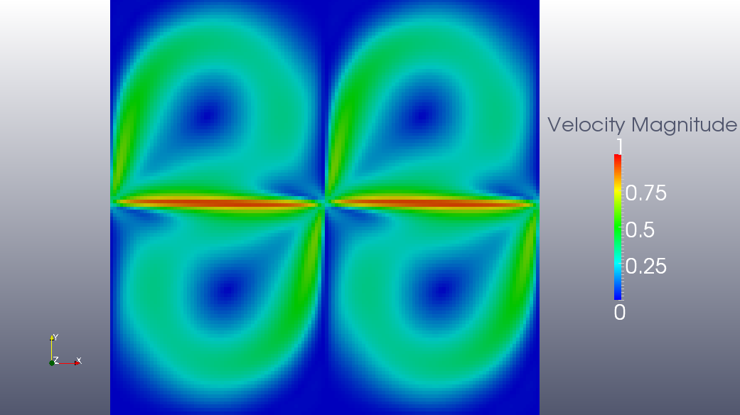

Jacques Fontaine
Re: Simulation of air flow in a room
I have attached an example: a single lid-driven cavity transformed into a 4 lid-driven cavities.
JF
JF
