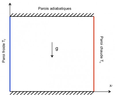

Besides, I'am working on the natural convection (Boussinesq approximation) with a high Ra number 1.5x10⁹ in a square geometry(1mx1m).The mesh is 100x100. left side is hot 300.5k, right side is 285.5k, the other two walls are adiabatic. When I finish the calculation, I find that the temperature on the left and right side are slightly changed, not exactly the temperature I fixed. all the three LES models (smagorinsky,wale,dynamic) have the same problem. When I seclect DNS( no model), this problem dosen't exist, the temperature on the boundary are exactly the value I set. If I forget some part when I use LES model?

Concerning your natural convection test case, the temperature your see at the wall is indeed not exactly the one you imposed. It is in fact only a matter of post-processing: given you are using a LES model (it would be the same in RANS) you use a wall function at the wall. Consequently, the temperature you impose at the wall is used to compute the corresponding flux at the wall. In order to impose that computed flux, the code set where and are the boundary condition coefficient. That is that which is post-processed (and not the one you impose).
If you do a DNS, then no wall functions are used, and is exactly the one you impose.
What is the in your simulation?
