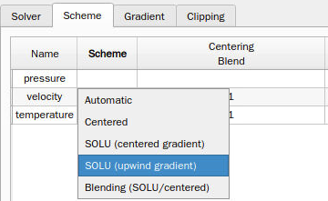

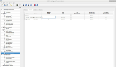

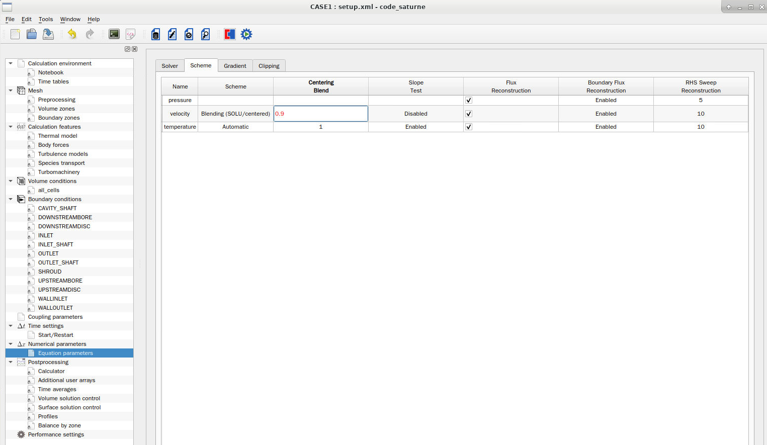

I would like to experiment with different numerical schemes for the velocity field. However, I have encountered an issue in the GUI: regardless of which discretization scheme I select (e.g., Blending SOLU/centered), the "Centering Blend" field seems restricted to a value of 1. If I try to input any other value (such as 0.9), the input box turns red and is considered invalid.
Could someone please advise if this is a known limitation in the V8.3 GUI, or if there is a specific setting (like Slope Test) that must be toggled first?
(42.84 KiB) Not downloaded yet

The slope test does not need to be toggled, as it adjusts to the scheme.
It seems the setting is disabled whenever you are using an LES turbulence model, because in this case a sencond(order scheme is required. In practice though, we seomtimes recommend adding 2% upwind (perhaps even) to some LES computations. Enough for stability, not too much to avoid degrading the scheme order too much.
But today, this can only be done in user-defined functions, though I will discuss this withe colleagues, to see if they agree we could relax this constraint in the GUI.
Other wise, yes, if you have 0.8 blending, it means you combine the centered scheme with a weight of 0.8, and SOLU with a weight of 0.2.
