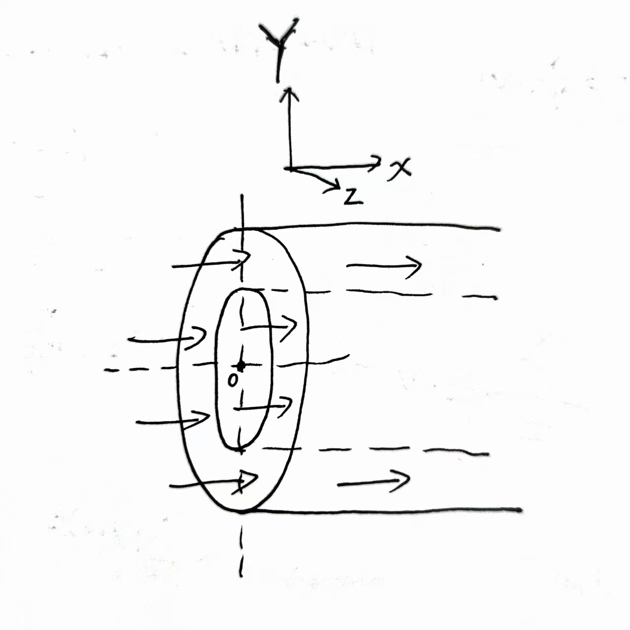

Geometry: Annular inlet (Outer Radius = 0.07m, Inner Radius = 0.052m).
BC: Inlet axial velocity = 2.93 m/s.

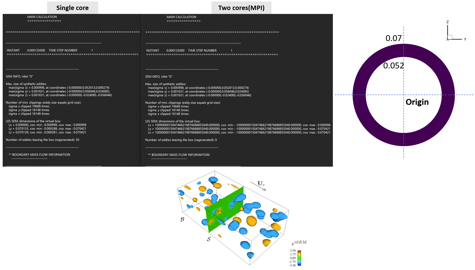

However, the run_solver.log indicates that the dimensions of the SEM virtual box are infinite. It seems the algorithm calculates the maximum coordinates correctly (matching my geometry), but the minimum coordinates (coo_min) are stuck at a negative infinite value (approx -1e30).
Here is a snippet from the log:
SEM INFO, inlet "0"
Max. size of synthetic eddies:
max(sigma_x) = 0.007668, at coordinates (-0.000000,-0.052013,-0.000274)
max(sigma_y) = 0.007668, at coordinates (-0.000000,-0.052013,-0.000274)
max(sigma_z) = 0.007668, at coordinates (-0.000000,-0.052013,-0.000274)
Number of min. clippings (eddy size equals grid size):
sigma_x clipped 0 times
sigma_y clipped 0 times
sigma_z clipped 0 times
LES SEM: dimensions of the virtual box:
Lx = 1000000015047466219876688855040.000000, coo_min : -1000000015047466219876688855040.000000, coo_max : 0.007668
Ly = 1000000015047466219876688855040.000000, coo_min : -1000000015047466219876688855040.000000, coo_max : 0.077651
Lz = 1000000015047466219876688855040.000000, coo_min : -1000000015047466219876688855040.000000, coo_max : 0.077651
Number of eddies leaving the box (regenerated): 0
run_solver.log

Hi everyone,
I have some new findings regarding my simulation.
I discovered that when I run the calculation using a single core (serial), the "infinite virtual box" error does not occur. However, as soon as I switch to multi-core parallel computation (MPI), the virtual box coordinates become infinite again.
Furthermore, even in the single-core case, the dimensions of the virtual box seem incorrect:
It only covers the inlet area located in the first quadrant (positive Y and Z coordinates), instead of the full geometry.
It has zero thickness in the X-direction (the streamwise direction), showing Lx=0.
I am currently stuck on this issue and would be extremely leaf grateful for any guidance or suggestions.
Thank you very much in advance.
run_solver(single core).log
(32.67 KiB) Downloaded 169 times
