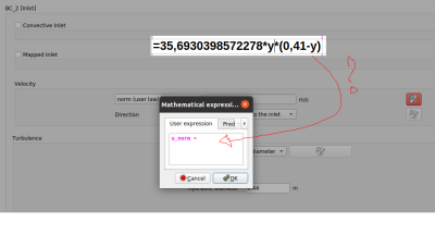

Hello i'm trying to WRITE a parabollic velocity inlet as described on the following picture

Can't see the linked image. I don't see where is the difficulty here. Did you try setting the formula you need ? Also check the rabbit showing available variables.

In the post
https://www.code-saturne.org/forum/viewtopic.php?p=3675&hilit=inlet+parabolic#p3675
user law was based on (sic)analytic functions vx(x,y,z), vy(x,y,z) and vz(x,y,z) (in Cartesian coordinates)".
in my case it 'd be vx=35,693*y*(0,41-y), vy=0 and vz=0.

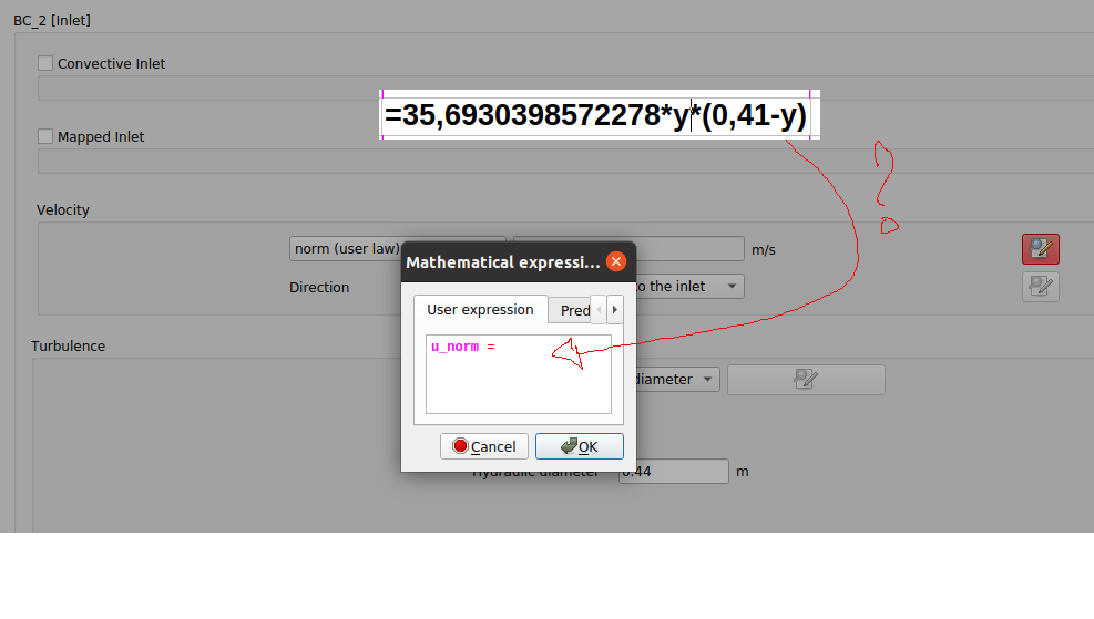

However in my GUI the user law is defined as
u_norm=
So i wondering if
u_norm=35,693*y*(0,41-y)
does work?
Regards
Posts: 4300
Re: parabolic inlet
In the GUI, you also have a second option for the flow direction: either normal to the inlet, a given vector direction, or a second user function. So you can combine the direction and norm definitions to get the desired velocity profile.
