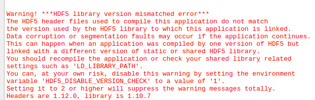

EDIT2: Also i've been receiving always the same warning message as soon as the compilation of the SRC files ends (see attached files). I wonder whether that might be the real cause of the buffer overflow as i've attempted several different solutions in vain until now...

Hello everyone,
I actually managed to solve the issue as it was related to the incompatibility of the libraries between MEDCoupling and HDF5 used at time of code_saturne compilation. Yet another problem arises as the thermo-chemical fields i'm working on, actually don't get initialized with the due values but simply with those introduced via the GUI. Any advice on how to manage this?
