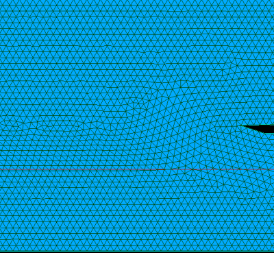

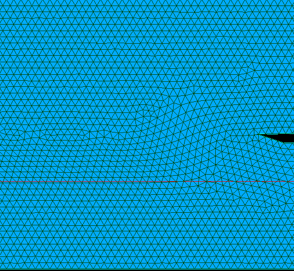

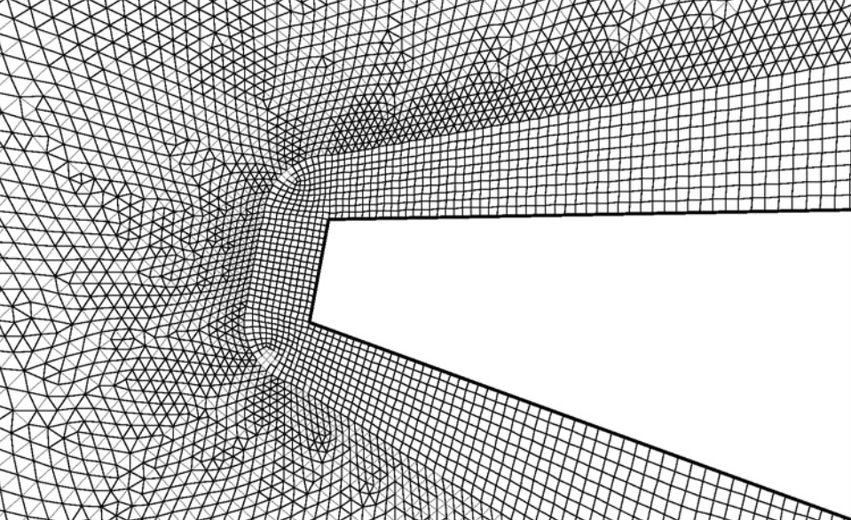

Re: meshing criteria
Thank you for your reply,
Indeed I am trying to achieve something similar to image10 (see attachement), and so far I can get the mesh you can see on image20 using netgen2d-1d, are there any tutorials or posts that treat similar problems? Also, what is exactly the difference between meshing my 2D geometry->extrude and meshing the 3D geometry directly?
Kind regards.
This type of mesh can be done with Salome using the Viscous Layer Hypothesis.
Here you have a link to examples and docs.
https://docs.salome-platform.org/latest ... eshes.html
Luciano
