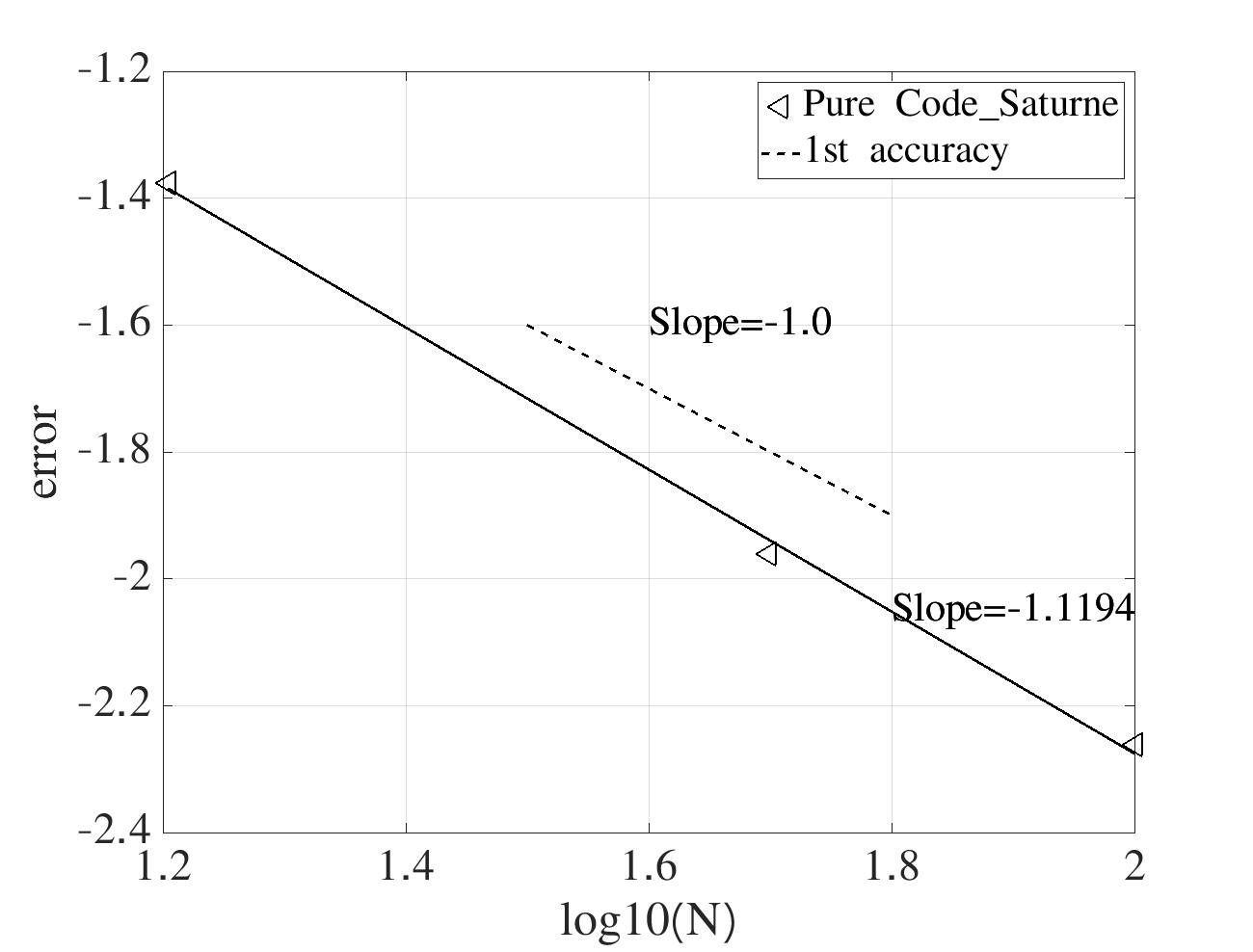

I did a convergence study using Code_Saturne v7.0.2. I tested a pseudo-3D Poiseuille flow with inlet boundary (u=4.0*(y-y*y)) and outlet boundary. Also, the domain is (1m * 1m) and uniform mesh with 16, 50, 100 resolutions. In order to ensure accuracy, I set SOLU velocity scheme. However, my results shows about 1st accuracy. Do you think this is reasonable for this case? Here I attached convergence results and setup file.
[img][PureCSaccuracy.jpg]

In most of our verification cases, we obtain 2nd order convergence, so your results are a bit surprising.
Did you test using the default centered scheme ? SOLU is somewhat more robust, not more precise.
Also, what type of mesh are you using ?

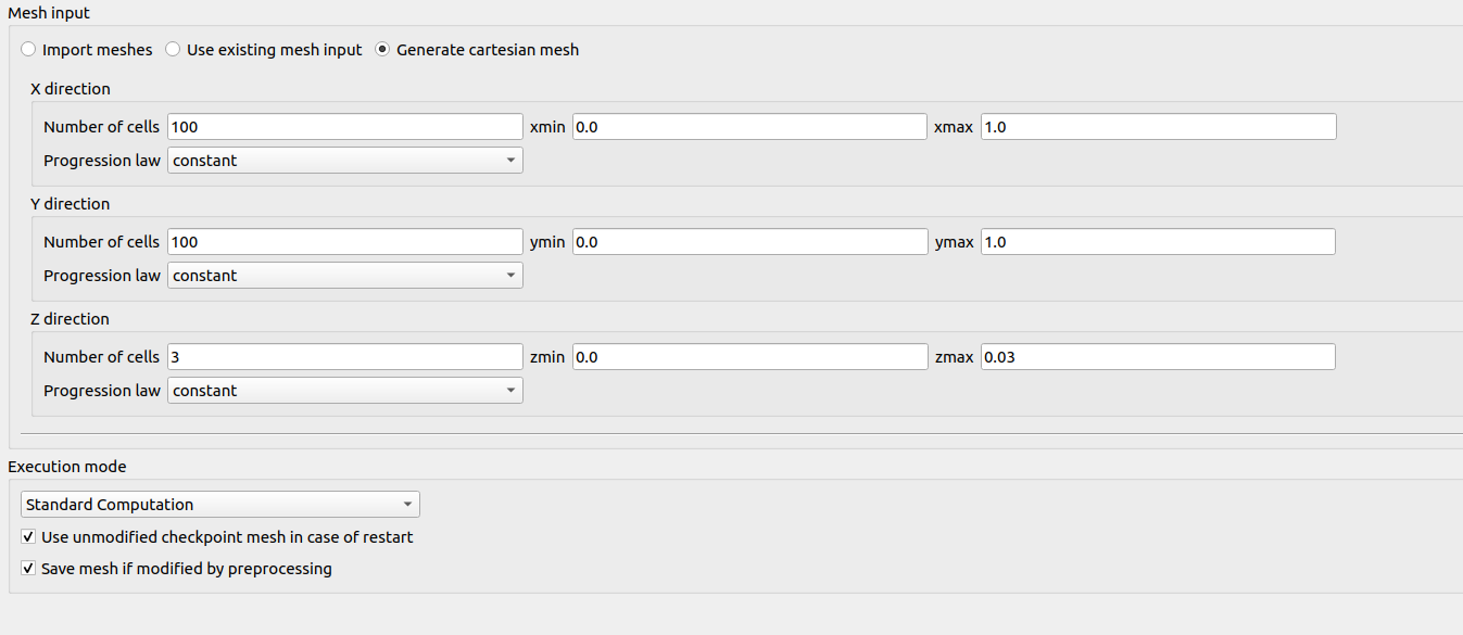

(2)what type of mesh are you using ?
I generate mesh using Code_Saturne GUI, as shown below.

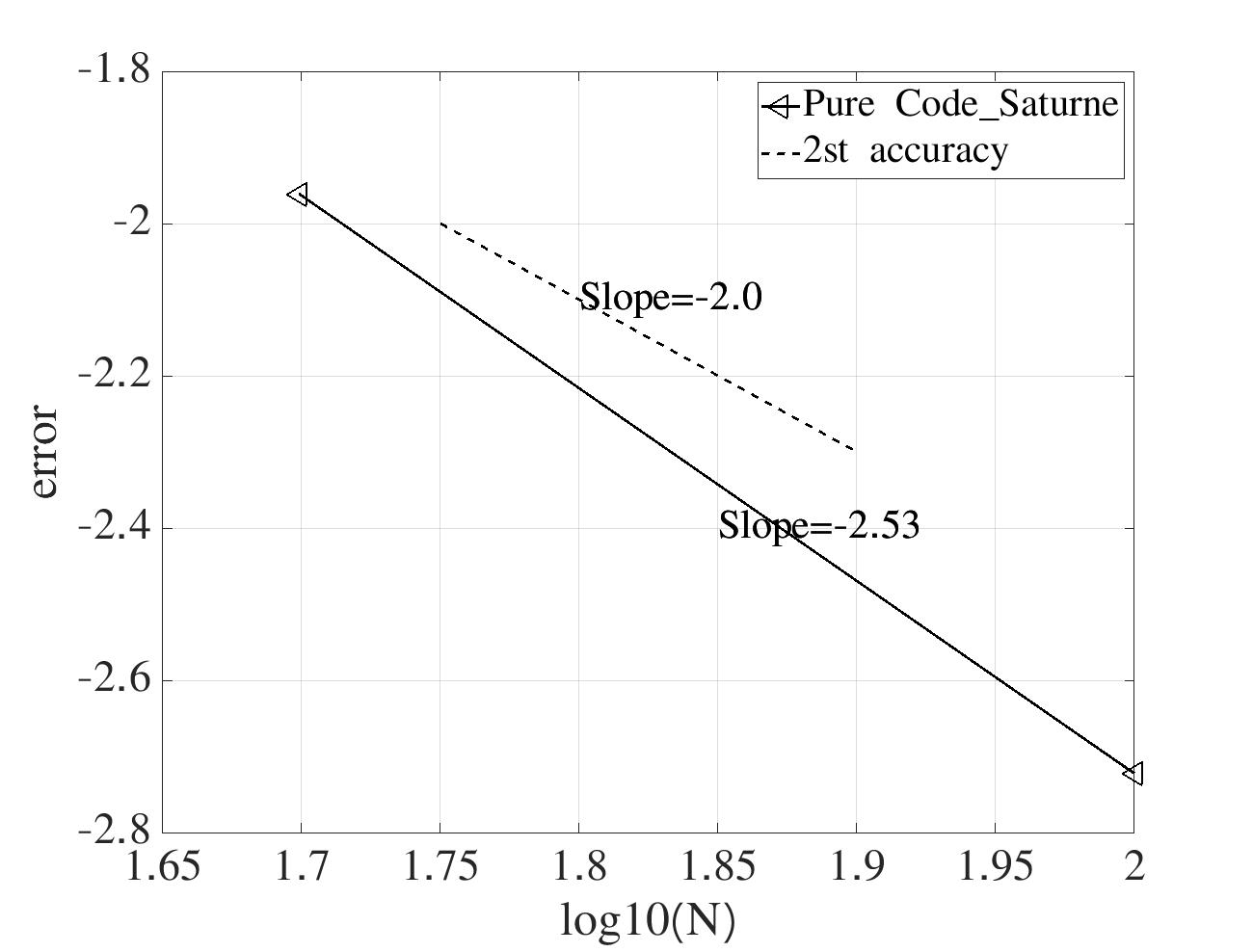

Thanks for your advice in post-processing. I know the reasons and list here in case someone has similar questions:
(1) I should extract velocity component instead of resultant velocity.
(2)I extract data from the cell centre and avoid any interpolation scheme.
(3)I use velocity centered scheme in Code_Saturne.
Below shows the good results:
Thanks!

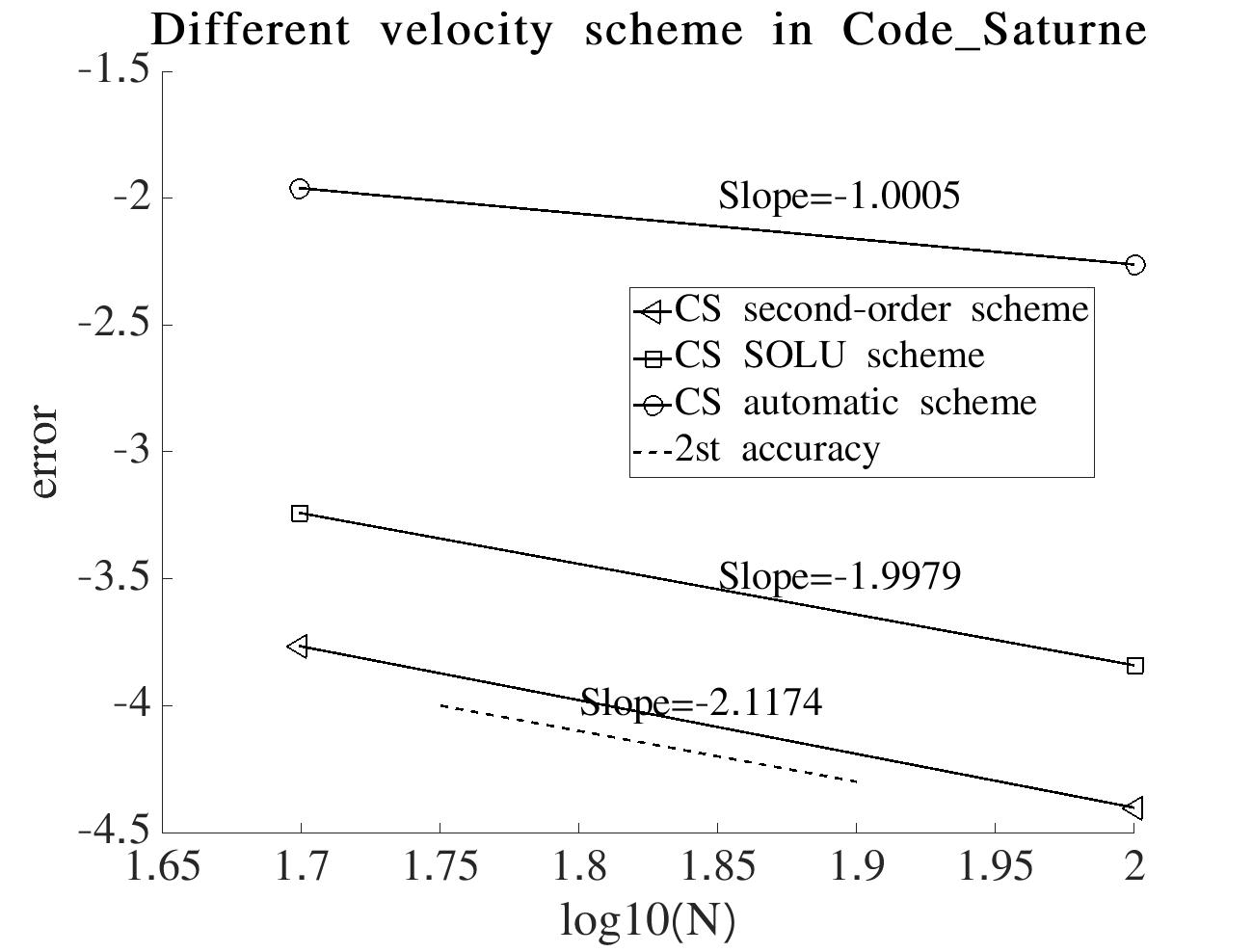

I have tested Code_Saturne three velocity scheme -- automatic, SOLU and second-order scheme.
As you predicted, SOLU and second-order scheme show excellent 2nd-order accuracy, but second-order scheme has lower error. The default setup (automatic) only has first-order accuracy, as shown in below figure.
There is an upwind scheme I didn't test (1st-order accuracy?). If I set automatic, Code_Saturne will adopt which scheme?
Correction: In previous conversation, I showed SOLU scheme has slope -2.53. This result is error because wrong boundary treatment in post-processing.

Re: Convergence study in Code_Saturne
Hello Yang,
The default is centered. Or more precisely, centered with slope test. When the slope test kicks in for a given face, it locally switches to pure upwind (for that face and operation), so the convergence order drops to 1. (There is an advanced setting allowing to use blending here, but it is still work in progress).
