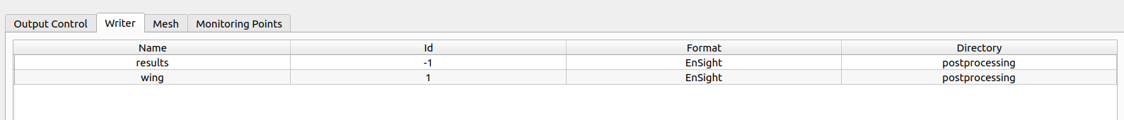

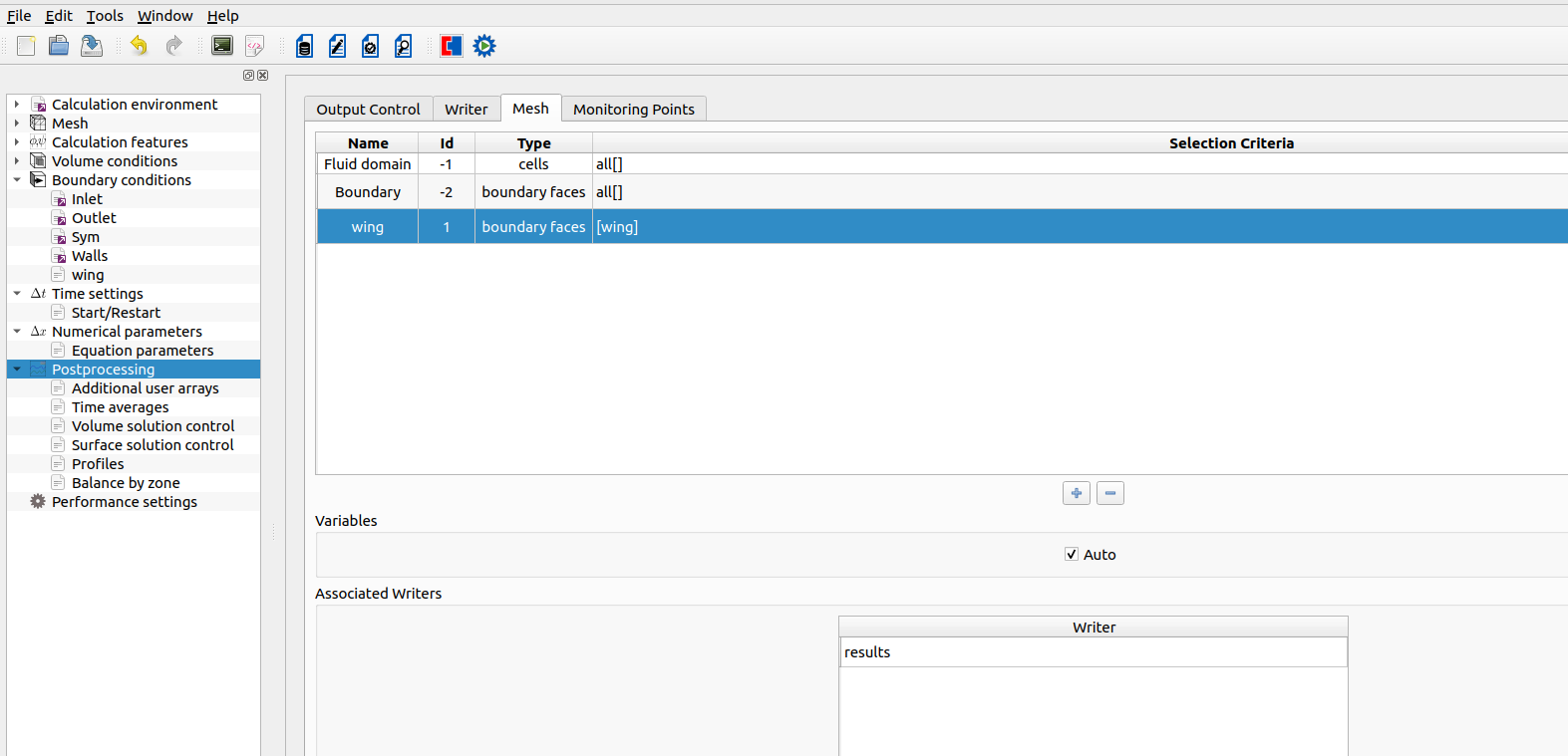

When you say add user defined fields in the GUI, do you mean something like in the attached screenshots?

In addition to this, using the GUI, you can generate postprocessing sub-meshes matching your surface groups, and associate them to the same or separate writers (don not forget that step). This allows you to visualize/sum/plot the results on these filtered groups.
Re: Output forces on surface

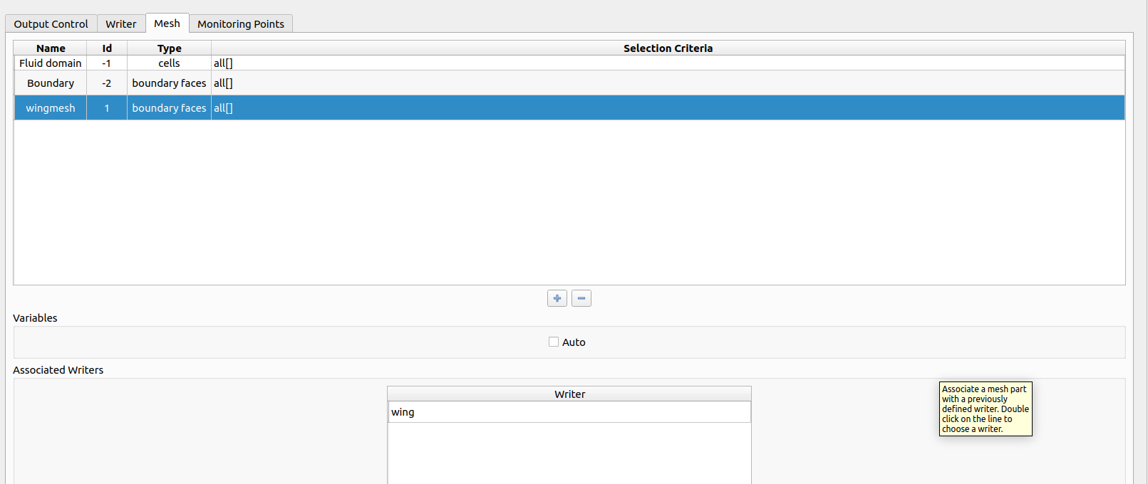

Thank you Yvan, I'm trying to do it using the GUI. My face of interest is called 'wing' so I have set it up as shown in the screenshot below. However this gives me the error:
How should I express the selection criteria to just include the boundary face called wing?
Error parsing expression:
[wing]
Expected operator instead of operand.
Ah, so it looks like just having wing without the square brackets works.....
No, that still doesn't seem to be working, there doesn't seem to be any data when I open RESULTS_WING.case in Paraview.
