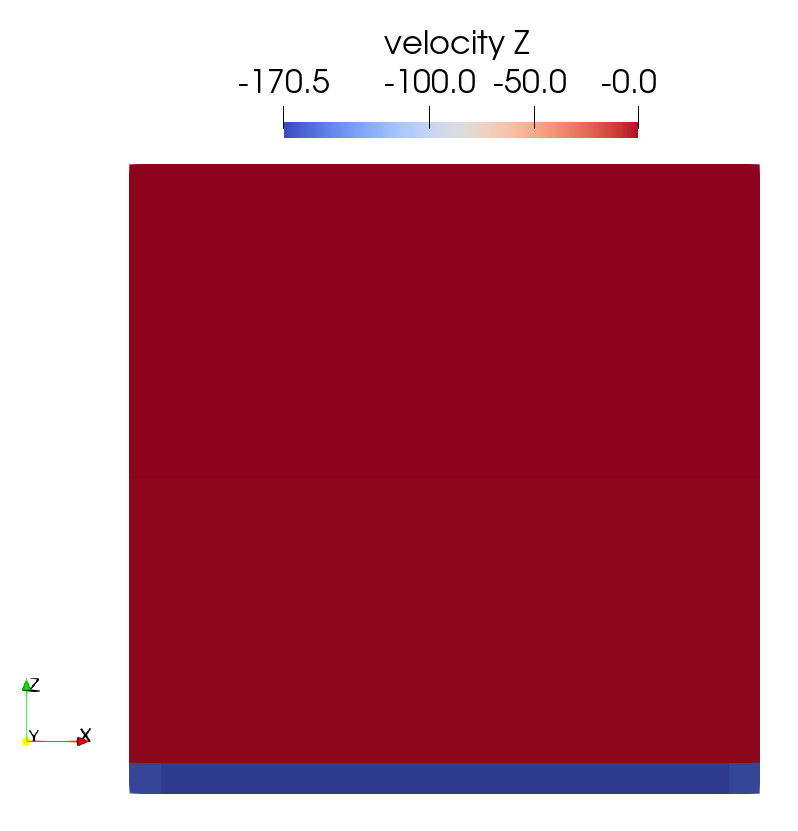

I would like to make a demonstration case of segregation phenomena during the solidification of a binary alloy. To do this, I'm trying to use the CS solidification module with CDO scheme approach (v8.0.2), and I'm facing a problem I don't understand concerning the gravity consideration.
I joined a simple case to illustrate my problem :
- A square 0.1*0.1m, 400 elements
- Activation and input of a binary alloy, with temporary simplification to cancel the Boussinesq term (Beta_T = Beta_C = 0)
- Adiabatic condition everywhere
- A uniform initial temperature above the melting temperature, so a full liquid domain
With such conditions, I expect nothing to happen. It's ok without gravity. But with standard gravity, I observe velocity along the gravity direction, with very strong values at the boundary facing this gravity direction, and a continuous warning in the listing file about the Picard algorithm which reaches the max. number of iterations when solving equation "momentum". There is no pressure, no density variation, so I don't understand what's going on. Would there be some opinion or advice?

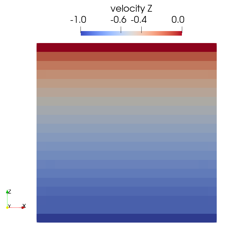

Here are some additional files concerning obtained results (listing file and images of Vz component field).
Matthieu

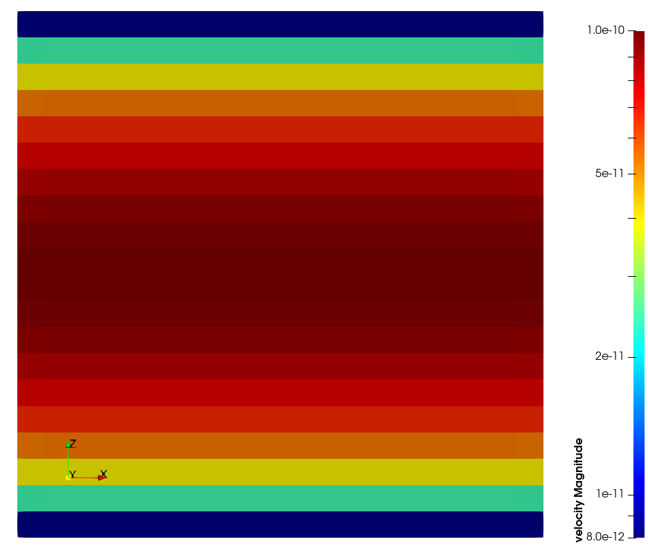

I carried out some tests based on the previous cs_user_parameters file (with gravity, but no physics about solidification at this time), here are some reports :
=> With the 2D square 0.1m*0.1m case previously described, simulations seems to make sense (negligible velocity), but I noticed a very (very) strong increase of time simulation and used memory with mesh refinement. For example, with a structured mesh of 250k elements, the joined performance.log file talks about 10.5Go of used memory, and a total CPU time of 174382s for 100 iterations (the simulation ran with 4 MPI ranks and 2 OpenMP threads), which sounds huge for this kind of mesh... Set the gravity to 0 doesn't change so much obtained results, except for a slighter MUMPS number of solves concerning velocity (10k vs 15k). Does it make sense with the solidification module / the CDO approach / the use of MUMPS, or do you think there is a problem with these stats?
=> With a similar setup in "industrial dimensions" (2D rectangle 0.65m*2.67m), the simulation is OK with a very coarse mesh (700 elements, dx=0.05m), but there is a non-convergence of the solver with a finer mesh (17k elements, dx=0.01m), similar to what I obtained at the beginning of this topic (cf. joined mesh et setup.log files).
