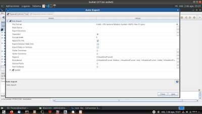

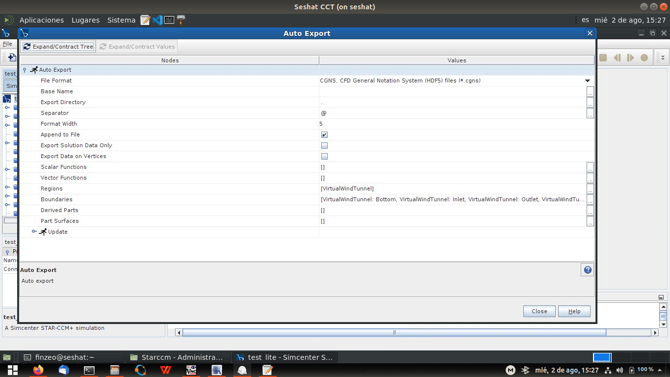

Sorry for the delay. I generated several files just in case, using different options to export. I see that in another post a problem arose that can be linked. I understand that, in my case, the version of the library is 3.21. I also attach the options that appear to me to export from the software.
