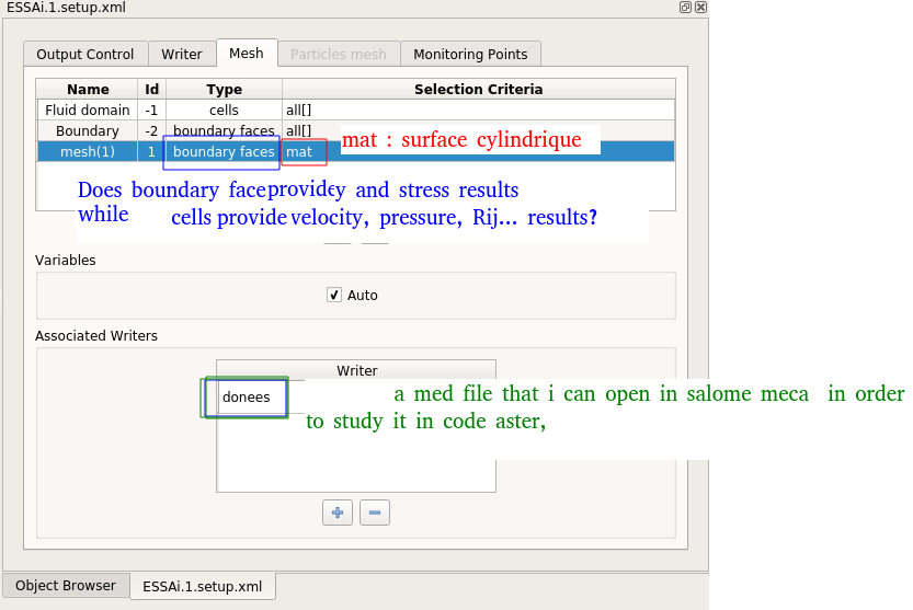

You can define additional postprocessing meshes (subsets of existing meshes), and associate them to writers in the postprocessing section.
I recommend defining a boundary surface mesh corresponding only to the cylinder surface.
Reading that in ParaView, exporting to other formats such as .csv should be easier.

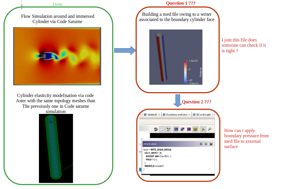

Actualy, my goal is to do a 2 way coupling between code saturne and code aster.
Before exploring the coupling patch I’m trying to do it step by step :
Fluid modelisation and pression results on cylinder surface with code saturne
export boundary condition in code aster and calculate node’s displacement
Determination of the new cylinder shape
Fluid modelisation and pression results on new shape cylinder surface
I have read one of your old post viewtopic.php?t=1767
and i try to follow your advice. Therefore i have created a med writter in order to export mesh and boundary condition (cf image). You were talking about using user subroutines, such as cs_user_postprocess_var.f90, to obtain only pressure information. Could you tell me a little more about this type of process or indicate a link to work on it
Best regards

For the shake of clarity i would like to know :
Is my med file i correct ? : How to associate pressure boundary condition from C saturne to C aster?

Ok. I just checked your "donnees.med" file, and it seems correct. You can probably also choose to output the full stress as a single vector, instead of separating shear stress and normal component, but that depdens on what is best for your coupling scheme.
Since all of this can be configured with the GUI, you do not need to spend time with cs_user_postprocess_values, especially if you have a deadline

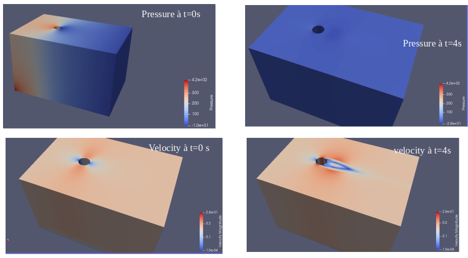

Hello, I have several problems to export my results.
At first i’m wondering about the quality of my cfd results. Indeed, although my velocity results accord to experimentals results (Von Karman allée, good vortex frequency) I’m not sure that pressure one are right : As indicate in the picture below i have a constant pressure while velocity on the cylinder is very turbulent :
And obviously, my Stress boundary med file export descripte not the stress leads to turbulent velocity, but only static pressure depending on the depth and à t=0s, therefore i have ticked (for the med writter) output at end of calculation
If someone can take a look at the attach files ang give me some advices it will be greatfull

The problem seems to be linked with gravity option. In fact if i untick (oz) gravity i obtain a good med stress file (joined)
