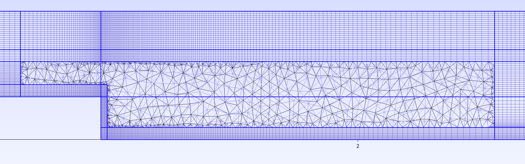

I am performing a computation of flow through a downward facing step with periodic lateral boundaries. I use a mesh composed of both structured cells in some regions and unstructured mesh elsewhere. I need to use the joining face option in order to include the non-structured area in the domain (otherwise it is considered as a wall). I have to avoid non-conformal mesh because of some user functions.
The mesh is conformal but cells at the front periodic boundary are different from those at the rear wall. I think that this is the reason for the following message in the listing file (see attached file listing.txt):

I selected all the surfaces of the non-strucutured area for the joining face and I declared the entire front and rear surfaces as periodic conditions (including the surfaces of the non structured areas). Is that the good way of doing it?
The setup file and an insight of the used mesh are attached (note that to simplify the reading, the cell size in the non structured area has been increased, the cells of the front and rear periodic conditions are very close when I use more refined mesh, but they are not exactly the same...).

If the meshes are almost but not quite perfectly aligned due to precision issues, you can try to increase the periodic joining's tolerance. Increasing it too much will degrade quality and possibly lead to a crash, so go by small steps.
Depending on how you build the mesh, you may have more or less control. If you build in a bottom-up manner (channel sides first), you may be able to apply the mesh from one side to that of the other before meshing the volume.

Thanks for your answer Yvan. I forced GMSH to produce identical cell pattern at both periodic frontiers. One problem solved ! ;)
