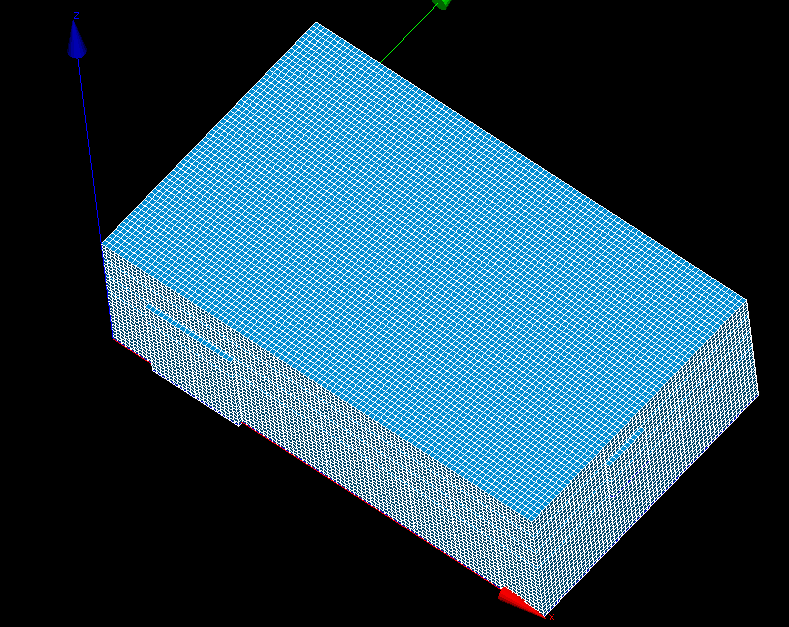

My case is rather simple and composed only of uniform squared cells (picture below).

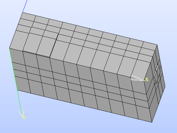

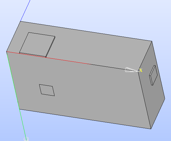

In this simulation, I want to implement a squared fuel inlet on the "ground" of my room as shown on figure 1 (View from below). In this way, I created a plane using the "create a plane" tool and I stuck it on the low face of the "air" domain (the big blue rectangle).
Then, I again created multiple planes using the "create a plane" tool in order to partition the whole domain using the "partition" tool which leads to what we can see on figure 2. (I did something similar to what it is done on the "Full domain simplified nuclear vessel" tutorial).
The thing is that maybe I first needed to partition the "air domain" with the "fire inlet" squared rectangle and then partition the newly get domain in order to get enough "line" to ease the mesh creation. That's what I did this morning and it seems it removed the previously quoted error.
In any case, the mesh does not change but this additional step allows to remove the issue while processing with "mesh quality criteria only".
If things are not clear in my explanation, I am available to discuss it online on your request.
Yours faithfully
Guillaume THIRIET
