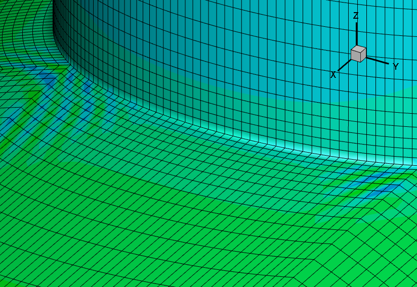

I am running a LES in a T-junction. Synthetic turbulence is applied at the inlets through the subroutine. The fluid is liquid metal which has a high thermal diffusivity. The LES was restarted from a RANS result.
The simulation diverges as shown in the temperature contours below.
But if I deactivate the flux reconstruction option, it seems running OK. Is flux reconstruction compulsory? The setup log and run_solver log are attached.

When you deactivate flux reconstruction, If I am correct, the scheme becomes non-consistent (or at least lower order) for meshes with non-orthogonalities.
Using this, computations tend to be more robust relative to mesh quality issues, but with degraded quality.
So I strongly recommend not deactivating reconstruction for an LES (it seems OK in RANS for variables such as k or epsilon, but not for velocity). Instead, you may increase the number of sweeps, or add a small percentage of upwind (2%).

Also, I want to say that what I see on the pictures looks like checkerboard effect but not divergence. There was a discussion about such problem, the result, as I remember, was: with small timesteps we have checkerboarding, with large timesteps - divergence. I think that increasing timesteps (I described how to archive stability) or tetra mesh may help.
